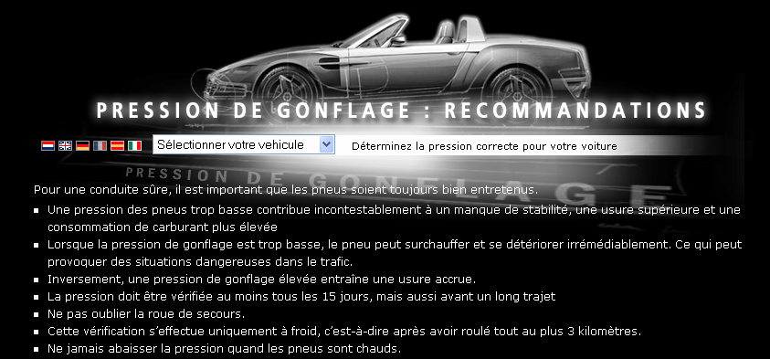

user posted image
user posted image
user posted image
