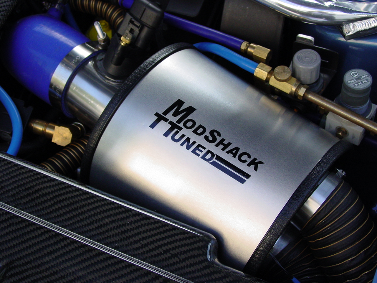

je me suis renseigné et ça donne ça
Here is all the info on the TTDA.  I can fit your 225 Quattro with no problem.  I am not sure if they will fit onan S4.  I have the correct adapter for a MAF, and at least one has been ordered for that car, but I have never seen an installed picture so I am unsure.  Take a look and determine.  Size of the TTDA is 8 inches across and 8 inches long without the flange.  The one I sent to a guy for his s4 loked like this:
http://public.fotki.com/ttschwing/ttda_and...s/dsc02818.html  He requested an extended flange.
Let me know if you have questions!
Steve Schwing
Modshack TTuning
(252) 327-7737
TTDA general info:
TTDA stands for Twin Tube Dynamic Airbox.......  I came upon this particular design after a long time scratching my head and trying to figure out solutions to some of the TT's (and 1.8T's) inherent breathing problems.  A simple look at the stock airbox intake will lead you to the conclusion that breathing is somewhat restricted.  Some of the early hose collapse issues confirmed that (kinda like sucking through a straw).  Heat is also a big issue with turbo cars. Using the generally accepted formula that 1% of power is lost for every 10 degrees of heat over a certain point.  I originally started with a P-Flow open element filter on my car.  Thinking it would perform better if isolated from the engine compartment heat, I fabricated an aluminum faced insulating blanket and started measuring temps with a probe.  The idea had merit.  Thinking more, I decided that totally isolating the intake from the compartment and fabricating something that would look better, I looked around for something with the proper dimensions to replace the stock airbox.  I thought (correctly) that if I could feed this enclosed airbox from the front of the car, I would get gobs of cool air and possibly a bit of ram effect.  Turns out a one gallon paint can was the perfect shape/size, and I fabricated the first "ram" air sealed system using my existing filter, and some creative hose routing to the front of the car.  The restrictions of the TT design determined the dual (hence Twin Tube) feed design.  More temp monitoring led me to believe I was on the right track.  It worked.  Now to refine the idea.  Better, more heat resistant materials, some insulation, and a nice carbon fiber finish resulted in the early TTDA as we know it.  I've gradually refined the finish technique as well as the construction as I've learned more about laminating and painting.  The tubes are now laminated, sanded and clear coated with Dupont 2 part clear for a better look and more durable finish.  Temps in the box now run only a few degrees over ambient, giving the turbo and the resultant heat generated, a good head start at reducing eventual intake temps.  On my car, with an FMIC, Samco hoses etc., the temps out of the IC are 3-5 degrees C hotter than the air.  More power all the time, and no heat soak issues. As of this update, there are over 250 TTDA's in use in a dozen countries on TT's, Golf's, New Beetles, Jetta's, R32's Skoda's, and now 3.2 TT's.  Everyone likes them and the butt (and real) dyno says they work.  Cooler temps, faster Spool and better throttle response are the bottom line results.
Thoughts on:
Panel filter Upgrade: The issue is NOT the Filter medium, but the airbox design itself.  Air comes in through a small snorkle, changes direction 90 degrees, flows through the filter, and changes direction another 90 degrees before it heads off into the MAF. It's no wonder the MAF housing needs restrictive vanes and screens (18%) to smooth the airflow.
Open Element filters:  Remember, these do nothing but suck hot, 150 degree air from your engine compartment. Performance improvements "felt" are largely because of the noise.  Most use inferior, imported K&N lookalike filters.  You get what you pay for here and you're usually just paying for a knock-off filter and a piece of sheet metal.
Traditional CAI designs: Again, most use cheap, imported filters. These are quickly chewed up in the dirty lower grill envoirnment. Like sucking through a straw, a long intake tube to the filter is not the best for enhancing performance.
TTDA design: .  This design, unlike any other on the market, provides an insulated filter box , closely coupled to your MAF housing, with a wide variety of Fresh air feed options.  Only Genuine K&N filters are used along with the best in Carbon fiber, Stainless, Aluminum, and Phenolic materials. I hand build these to spec.
TTDA ordering:
Each is handmade to your spec. with choice of carbon or carbon/kevlar, brushed stainless, or custom color matched paint.  I build these in my spare time.    This came out of building a few for friends, and snowballed through word of mouth. Payments are generally handled through Paypal.  Insured Fed-Ex ground shipping is my preferred method for domestic deliveries.  USPS Global Express for Canada and Europe..  Let me know your Car, your color/finish preference, paypal me some funds and I'll get you on the build list.  i can generally ship within 1 weeks of your order. See new options in the pricing section:  Superinsulated TTDA, Aeroduct hose, Stainless endcaps,Mini-breather.  Please specify when ordering.
TTDA Airbox construction details:
Tube:              Non-Brittle Phenolic Microseam 7.5 ID x 8 inches long
Insulation:      Double layer air bubble insulation with dual aluminum skins for reflective and absorptive heat handling
Filter:            K&N Inverted cone #RR-300x, New with warranty card
Lamination:  Carbon fiber or carbon/kevlar weave.  Laminated with Epoxy then Dupont clear coated.
                      Stainless Version: T-304 Brushed stainless wrap.  26 gauge
Endcaps:        3/8 inch ply with Black carbon lamination (standard endcap)
Edging:          Vinyl with aluminum reinforcement (Choice of: Blue/Red/Gray/Black)
Intakes:          (2) Spun aluminum, 2.5/2.75" OD, or custom to your spec.
Clamps:        (1) Stainless
Cold Start line: Foam, slip on filter included
"No Tools" disassembly for filter cleaning
Construction and color pictures here: http://public.fotki.com/ttschwing/cai_ttda_and_other/

TTDA General info:
Stock air box snorkel inlet is about equivalent to a single 2.5 inch feed.
That's 4.91 Sq. inches.  Double that for the TTDA= 9.82.  Result:  More air,
less restriction
On temperatures:  The engine compartment gets hot.  Wander around in there
with an Infrared thermometer and you'll see!  For every 10 degrees of temp
increase you lose 1% in potential horsepower.  Reduce the temps, you
increase potential HP.  The TTDA reduces temps 2 ways.  Aluminum skinned
fiber insulation provides a thermal barrier for engine compartment heat.
Remote feeds provide a fresh (ambient temp) air source.
On flow:  In the stock airbox, air changes direction twice (90 degrees each
time) to get to the MAF.  Using the inverted cone filter, air enters the MAF
smoothly.  So smoothly in fact, that you can remove the plastic vanes and
screens from the MAF housing which is the biggest restriction in the intake
system.
More air, less heat, less restriction = More power and better throttle and
turbo response.
No other commercial (or otherwise) product on the market does what minedoes.
Specify VW, 180TT, 225TT, or 3.2TT.  adapter sleeves will be provided for your application.

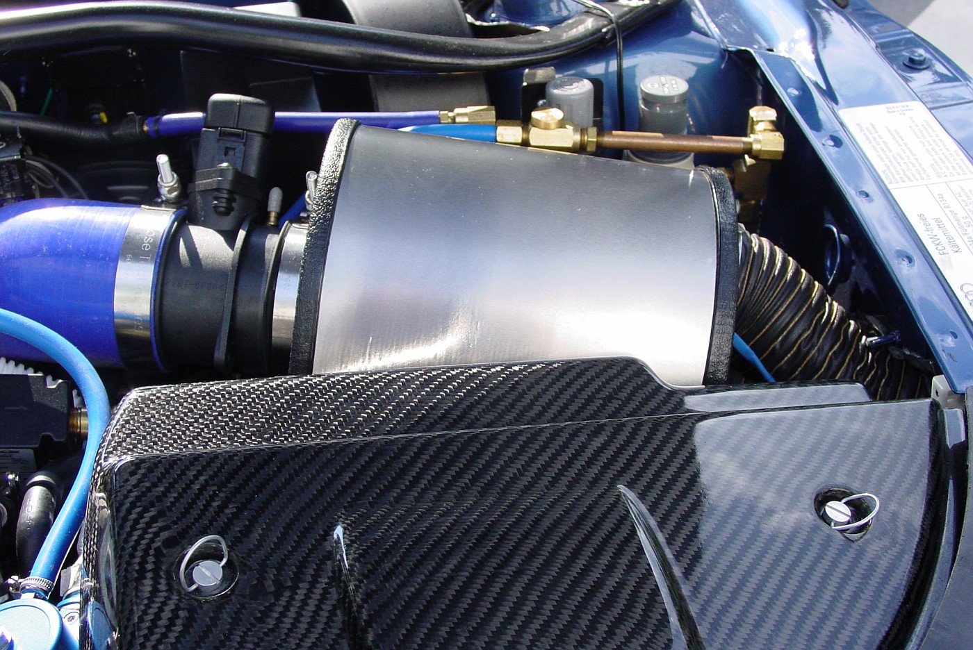

Set-up for OEM 225 car : (simple install)
You won't be able to take full advantage of the design without having an FMIC and running feeds into the free'd up grill area, but you will see advantages in less heat soak, and a less restrictive intake.  You may remove the plastic MAF vanes with this filter as it appears to supply a very clean flow of air to the MAF element. I currently have my vanes out.  This will make a big difference  The filter end will  fit directly on the MAF housing.  Lubricate a little as it is a tight squeeze.  The filter is sized so that no other support should be necessary.  It will nestle right into the OEM airbox area.  Run a short hose to the fender opening from the top flange. Feed through 6-8 inches or so.  Route the bottom into the area behind the headlight.  This will at least get you a little fresh air in there.  I use 2.5 inch neoprene hose.  Expensive, but better and more flexible than most.  This can be sourced at  http://www.aircraftspruce.com  P/N 05-29810. You'll need 7 feet for a full feed system, 3 feet for the quick install method. (available in 10ft lengths)
FMIC 225 Full feed (180TT or VW) car:
This is the best set-up but requires cutting a little metal (not necessary with the VW application) if you want to get the dual pressure feeds up to the box. If you can settle for one pressure feed, no cuts are necessary.    My Fotki pics show all these  pretty clearly, so I won't go into a lot of detail. http://public.fotki.com/ttschwing/ttda_and_other_inta/  More feed detail in the "Feeding the TTDA" album.  One hose up the fender liner side, and one up under the headlight.  You can get the hose through here with the front end on.  You may have to remove the battery box depending on how dexterous you are!  Both end in some sort of collector in the lower grill.  Mines a home-made, but commercial inlets are available.
Note on early 2001 cars and earlier with Xenons:  The Xenon ballasts on earlier TT cars are attached to the chassis under the lights, rather than on the actual light fixtures themselves.  Because of this it may be impossible to route the headlight hose without removing the front end and headlight.  The ballast needs to be relocated to allow for hose clearance.
Install album of various pics from TTDA users:
http://public.fotki.com/ttschwing/cai_and_..._installs_from/
Additional Install Notes:
Depending on how you intend to install the air box, here are some tips, links and notes to help you along:
Stock 225 , 180, or 3.2 (easy install method):
1) remove the stock box
2) lubricate the filter flange and clamp on to the MAF.  Orientation of the box should be with the seam down and the intake ports at about a 45 degree angle to the rear.
3) Hose routing can be simple but you won't get the Ram air effect.  You will get better flow and heat control though and 90% of the benefits.    I would highly recommend going with the high quality Neoprene as seen in my installs (Aeroduct 2.5 CAT).  Very flexible and should eliminate trimming sheet metal at the snorkel exit area.
This stuff can be sourced at http://www.aircraftspruce.com  PN #05-29810  or you can buy it with the TTDA in a package.  7 feet will let you do even the more involved install. 3ft' is plenty for the " simple " install.
4) Route 1 hose through the snorkel hole to get some fresh air, and tuck the other down behind the headlight.
5) Place the black foam sock over the cold air inlet tube you removed from the airbox side and zip tie out of the way. If you have the breather, slip into the hose end.
225, 180, 3.2 or VW with front feeds:
1) Mount as above  (180 or VW applications will have a silicone hose spacer in the filter end to match up to the 2 3/4 inch MAF)
2)  Most of the pics for this have been pretty well documented here: http://public.fotki.com/ttschwing/cai_and_...shack_3_mark_2/
The only tricky part is cutting a little sheet metal to the left of the fender liner screw hole as seen here: http://public.fotki.com/ttschwing/cai_and_...2/dscf0145.html
This is easily done with tin snips and then dressed up a bit with a dremel or die grinder. Cut until you can fit the hose in there without interfering with the fender liner when re-installed. You can also do a Hybrid install and not cut, running only the under headlight hose to the front.
The feed horns are simple parts available at Home Depot.  The angle bracket shown holding the assembly to the car is from the garage door dept. (Track bracket).  It's slotted and sized perfectly for this. There's even a threaded stud on the car to mount it too!  You can also use the stock IC Bracket that used to mount there for support.  Commercial air inlet ducts can be made to work as can other creative ideas but the space is tight.  Measure first!

pareil pour moi apres passage chez LRS a partir de 3000 trs ma pression baisse de 0.7 bars...
help c chiant quand meme!!!!!!!!
D'apres les posts de dede69, le pb a été résolu avec la mise en place d'une admission de grosse capacité.
Est ce que tu as parlé de ca à LRS ?
salut, bizarre que ça manque d'air a partir de 3000, vous savez a combien souffle le turbo ?
oui étrange car chez les autres préparateurs pas ce problème.
La pression est pas trop poussée?
faudrait remettre la main sur dede69 ... :coucou:
J'adore ses couvres moteurs et batteries en carbone ... :malelovies:
Yep car j ai moi aussi se probleme du trou a 3000tr/min
moi je te conseillerais d'aller voir LRS et de leur parler de ce qu'ils ont fait avec dede69 et sa prépa qui était pas loin des 270ch ...
pour ce probleme, lrs préconise les pti trous dans la boite a air qui atténuent ce "problem" (sans l'enlever complètement), sinon une durite renforcée
MaNuKoUtChI_IppO a justement fait installer une durite renforcé en meme temps que ca prépa, il a tout de meme le pb. Moi je dis que c'est un pb d'arrivé d'air, de quantité d'air plus exactement. Tout est dit dans le 1er post de dede69, y a pas besoin d'aller plus loin.
Pour finir, je crois que dede avais changer de preparateur... elle en marchais que mieux et n'avais plus de trous :bigsmile:
enfin moi je dis ca :coucou:
si ç'est le cas ,cela veut dire que la prepa n'est pas genial,car le turbo est poussé a ses limittes <_<
