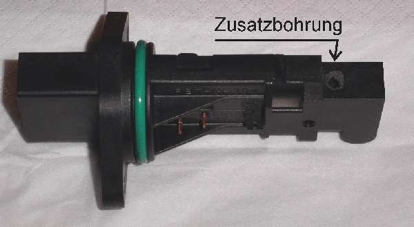

ici avec un trou ??? la foto vien de ?? foro internet.

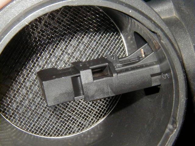

Le debitmetre marque Pierburg mesure l`air miex que le Bosch.

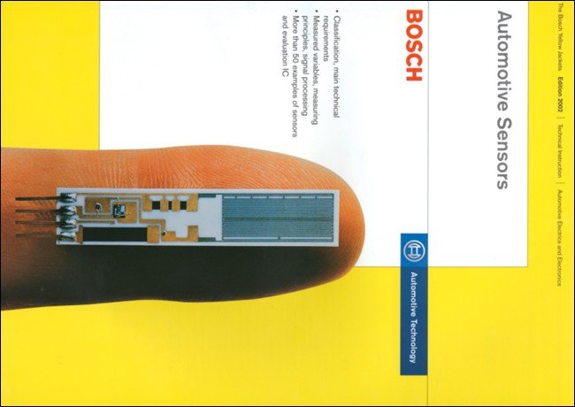

Apres ouvrir the Pdf link achiv...2003..
regarder svp pages 43-44-45
on verra le silicon sensor debitmetre .
0ne micron is 0,000.001 metre = 0.001 mm
plus ou moins is 7 microns longeur largeur ,rien de tout..

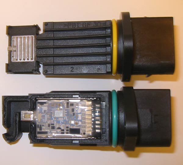

The APG motor a3 20v do not exist in the last list,maybe I am the first to test it
(The MAF DEBITmetre).
For people with interest in the Maf new technology Pierburg,this measure also
the antiretour air and the intake temperature.
The problems with A3 ,A4 ,etc. is also the EGR:n18 valve in my car ,the N80 valve from the gas tank,and the secondary air system in the cold start.
If this valves are sending air ,CO,CO2,HC,H20,etc en the output of the MAF,this one get confused and the motor lambda goes very far from the ideal point (1)
the car spend a lot of gas... if it is rich or lack of power ,like me with the Bosch
alarm p1128 lean .
What made me confused I am not mecanic is that the ECU bosch or the computer
in the car takes command even with the Maf damaged (futu diablotin.gif )
and the car runs with fixed air values speed dependent .
