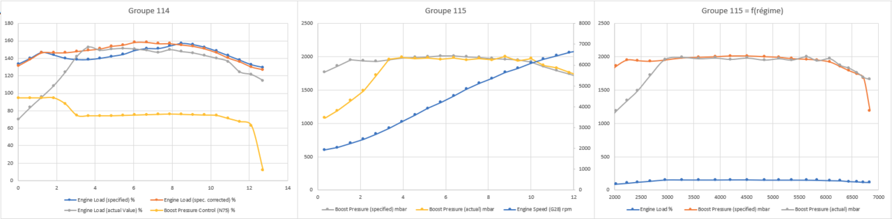

Bonjour
J'ai fait des log cette après-midi, juste avant la pluie.
J'ai suivi cette méthode (merci BK :bowdown: ):
http://forums.audipassion.com/topic/150074-vagcom-et-les-logs/
Log 114-115
Groupe A: '114
Engine Load Engine Load Engine Load Boost Pressure
(specified)(spec. corrected) (actual Value) Control (N75)
temps % % % %
0.35 97.0 95.5 18.8 0.0
0.95 97.0 95.5 18.8 0.0
1.55 97.0 95.5 30.8 0.0
2.15 113.5 111.9 50.4 0.0
2.74 122.6 120.9 50.4 0.0
3.34 124.1 122.4 60.9 0.0
3.94 142.1 140.3 66.9 0.0
4.54 145.1 143.3 27.1 0.0
5.14 139.1 137.3 10.5 0.0
5.74 145.1 141.8 74.4 39.6
6.35 143.6 140.3 85.0 34.5
6.95 145.1 143.3 94.7 0.0
7.54 143.6 140.3 91.7 0.0
8.14 144.4 141.8 6.8 0.0
8.74 141.4 140.3 18.0 0.0
9.34 139.1 137.3 18.8 0.0
9.94 142.9 140.3 79.7 95.3
10.54 145.1 143.3 94.7 95.3
11.14 145.1 143.3 112.0 95.3
11.74 145.1 141.8 130.8 73.3
12.34 142.9 140.3 152.6 65.9
12.94 142.1 140.3 154.1 65.5
13.54 142.1 140.3 146.6 65.1
14.14 142.9 140.3 151.1 64.7
14.75 144.4 141.8 150.4 63.5
15.35 145.1 141.8 151.9 63.1
15.95 147.4 144.8 152.6 63.5
16.55 150.4 149.3 153.4 63.9
17.15 154.9 153.7 155.6 65.5
17.75 157.1 155.2 154.9 67.1
18.35 156.4 155.2 153.4 67.1
18.94 153.4 152.2 148.9 66.3
19.54 150.4 149.3 140.6 64.3
20.14 154.9 153.7 6.8 0.0
Groupe B: '115
Engine Speed Engine Load Boost Pressure Boost Pressure
Rep�re (G28) (specified) (actual)
temps /min % mbar mbar
0.04 840 19.5 970.0 980.0
0.65 840 18.8 970.0 980.0
1.25 800 20.3 970.0 980.0
1.85 960 45.9 970.0 980.0
2.45 1560 48.9 970.0 990.0
3.04 1560 58.6 970.0 1000.0
3.64 1720 60.9 970.0 1020.0
4.24 2320 65.4 970.0 1060.0
4.84 2200 9.8 970.0 1080.0
5.44 1880 60.9 1050.0 1000.0
6.04 1920 85.0 1240.0 1100.0
6.65 2240 91.0 1140.0 1210.0
7.25 2600 92.5 1060.0 1270.0
7.84 2880 29.3 970.0 1330.0
8.44 2360 6.0 970.0 1080.0
9.04 1920 15.0 970.0 1030.0
9.64 1960 60.2 1000.0 990.0
10.24 2080 86.5 1920.0 1100.0
10.84 2280 102.3 1890.0 1250.0
11.44 2520 121.8 1860.0 1430.0
12.04 2760 142.1 1830.0 1650.0
12.64 3080 153.4 1800.0 1800.0
13.24 3400 148.1 1770.0 1800.0
13.84 3720 145.9 1770.0 1760.0
14.45 4000 150.4 1760.0 1780.0
15.05 4320 148.9 1760.0 1760.0
15.65 4600 153.4 1760.0 1770.0
16.25 4920 153.4 1770.0 1770.0
16.85 5200 154.1 1820.0 1800.0
17.45 5480 156.4 1850.0 1830.0
18.05 5760 154.9 1850.0 1860.0
18.65 6000 151.1 1820.0 1870.0
19.25 6240 145.1 1790.0 1840.0
19.85 6400 140.6 970.0 1790.0

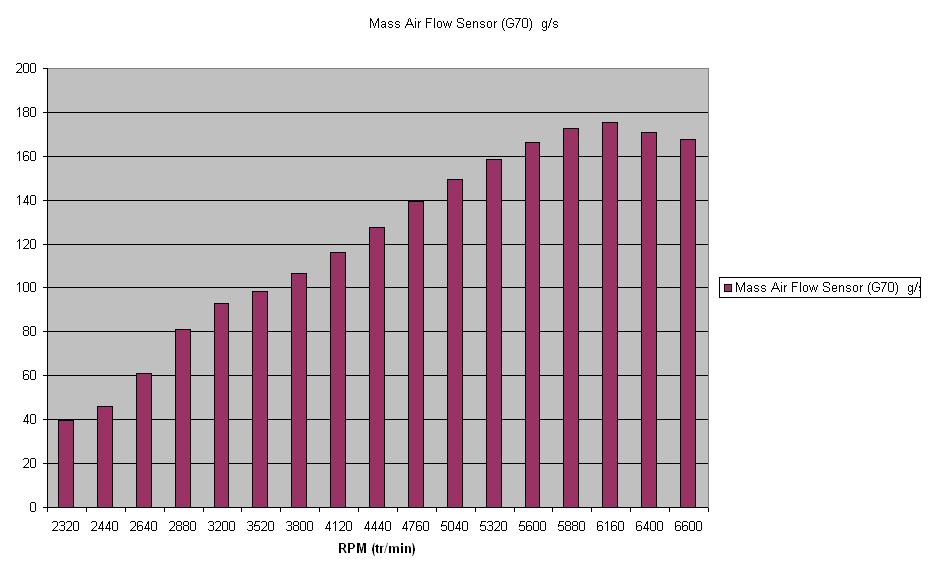

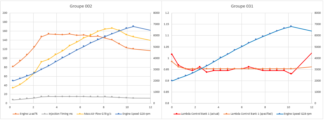

Log 002-031
Groupe A: '002
Engine Speed Engine Load Injection Timing Mass Air Flow
Rep�re (G28) Sensor (G70)
Marqueur temps /min % ms g/s
11.08 2000 7.5 0.00 3.03
11.68 2320 60.9 7.79 39.50
12.28 2440 91.7 9.02 46.08
12.88 2640 114.3 11.07 61.08
13.48 2880 139.8 13.53 81.11
14.08 3200 151.1 15.17 93.00
14.68 3520 147.4 14.76 98.44
15.28 3800 147.4 14.76 106.67
15.89 4120 148.1 15.17 116.31
16.49 4440 148.9 15.58 127.47
17.09 4760 152.6 16.40 139.36
17.68 5040 154.1 16.81 149.39
18.29 5320 154.9 17.63 158.72
18.88 5600 155.6 18.04 166.47
19.49 5880 154.1 18.04 172.81
20.08 6160 149.6 17.63 175.47
20.68 6400 142.1 17.22 170.92
21.28 6600 133.8 16.40 167.61
21.88 6560 17.3 2.87 40.53
Groupe B: '031
Lambda Control
Rep�re Bank 1 (actual)
temps V
10.78 0.040
11.38 0.000
11.98 0.740
12.58 0.800
13.18 0.810
13.78 0.820
14.38 0.830
14.98 0.825
15.58 0.830
16.19 0.840
16.79 0.850
17.39 0.850
17.99 0.860
18.59 0.860
19.18 0.865
19.78 0.870
20.39 0.870
20.98 0.875
21.58 0.880

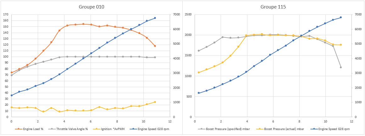

Log 010-115
Groupe A: '010
Engine Speed Engine Load Throttle Valve Angle Ignition
Rep�re (G28) Timing Angle
Marqueur temps /min % % �AvPMH
8.39 1880 9.0 2.7 9.0
8.99 1840 24.1 12.2 26.3
9.59 1880 78.2 84.3 20.3
10.19 2040 88.0 88.6 18.8
10.79 2240 100.8 92.2 17.3
11.39 2480 118.0 96.1 15.0
11.99 2760 136.1 98.4 14.3
12.59 3040 151.9 100.0 12.8
13.19 3360 151.1 100.0 14.3
13.80 3680 148.9 100.0 16.5
14.40 4000 148.9 100.0 17.3
15.00 4280 148.9 100.0 17.3
15.59 4560 149.6 100.0 17.3
16.20 4880 152.6 100.0 18.8
16.80 5160 154.1 100.0 19.5
17.40 5400 155.6 100.0 18.8
17.99 5680 155.6 100.0 18.8
18.59 5960 153.4 100.0 20.3
19.19 6160 148.9 100.0 21.0
19.79 6400 140.6 100.0 21.8
20.39 6560 132.3 100.0 22.5
20.99 6760 127.8 100.0 21.8
Groupe B: '115
8.69 1800 9.0 970.0 1030.0
9.29 1840 72.9 1700.0 1010.0
9.89 1960 83.5 1930.0 1110.0
10.49 2160 94.0 1960.0 1220.0
11.09 2360 109.8 1900.0 1340.0
11.69 2600 127.1 1880.0 1520.0
12.29 2880 146.6 1850.0 1720.0
12.89 3200 152.6 1820.0 1820.0
13.49 3520 147.4 1790.0 1810.0
14.09 3840 148.1 1780.0 1820.0
14.70 4160 148.1 1770.0 1800.0
15.30 4440 149.6 1770.0 1780.0
15.90 4720 151.9 1790.0 1790.0
16.50 5000 153.4 1820.0 1810.0
17.10 5280 154.9 1860.0 1830.0
17.70 5560 155.6 1880.0 1870.0
18.29 5800 154.9 1870.0 1890.0
18.89 6080 151.1 1830.0 1890.0
19.49 6280 144.4 1790.0 1860.0
20.09 6480 137.6 1770.0 1840.0
20.69 6680 130.1 1750.0 1800.0
21.29 6680 93.2 970.0 1690.0

Dites-moi ce que vous en pensez?
De mon côté en conduite je n'ai pas trouvé de problème.
Merci
salut,
Ca me parait parfait :
- pression normale
- duty N75 cohérents
- peu de reprise à l'allumage
En plus, tu n'as pas d’ac-coups donc gaz :D
Déjà :bien:

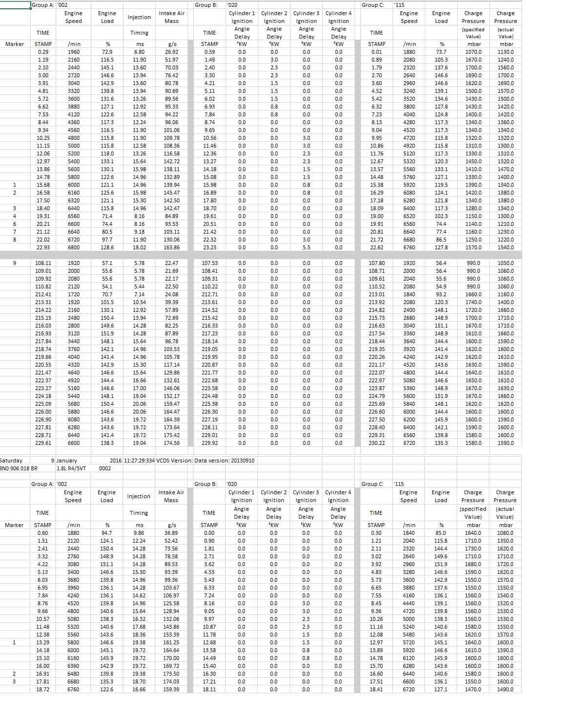

Voici les logs du jour:
Ok, si tu peux faire 002 115 et 031 en faisant plein gaz des le début ? Parce que la rien ne cloche à part que tu as très peu de pression consigne!

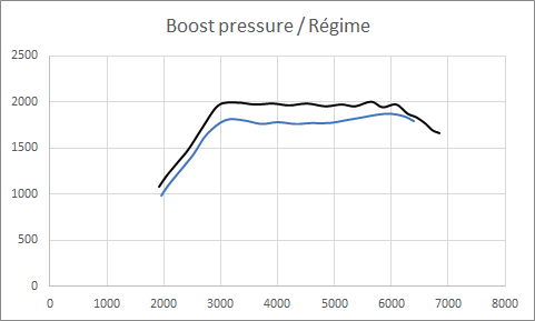

A la demande de Erlin, je poste les courbes de pression de turbo, et les manquantes:
@+ Sébastien

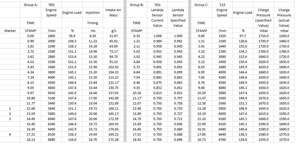

Hello,
Voici les mesures du jour, sous la pluie :

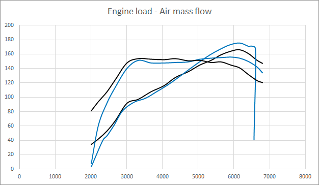

003_ti11.jpgOn dirait bien que que la valeur de la lambda arrive en butée, est-ce normal?
J'ai dit des bêtises plus haut, ta pression consigne est bonne pour 180cv.
Ton débitmètre lit haut en effet. As tu eu des coupures ce coup là ? La richesse suit plutot la consigne. C'est mégariche mais origine c'est comme ca et que ton débitmètre lise trop enrichit encore plus.
Ton débitmètre vient d'ou ? c'est bien celui pour ta voiture ? tu n'as pas changé que le capteur ?
Non, pas eu de coupures.
Le "corps" de débitmètre est un bosch.
Le capteur de débitmètre a été remplacé par un pierburg (d'après les anciennes factures). Il a env. 40.000kms.
D'après la référence (370107P), c'est bien un pour 180ch.
Bon ça me rassure pour la pression :icon_smile:

Je déterre ce post qui me semble le bon endroit pour poster des logs de 225 ch
Mes logs du jour, qui me donnent ~186 ch. Il en manque encore pas mal pour arriver à ses 225 d'origine, malgré pas mal de changements :
- Bougies, bobines, pompe à essence, dump valve, toute les durites sous le collecteur d'admission, recalage de la distribution, etc ...
Je n'arrive pas à comprendre ce qui me bride à ce point, c'est super frustrant !
La voiture approche des 200 000 km, comment savoir si le turbo est fatigué ?
- sachant que j'ai plus de pression que SM18 au début de ce post. En bleu les valeurs de SM18 et en noir les miennes
Même chose pour le débitmètre ?
- sachant que je ne dépasse pas les 170 g/s
En bleu les valeurs de SM18 et en noir les miennes.On voit que ça se joue surtout à partir de 5000 rpm.
C'est le jeu de la poule ou l'oeuf. Est-ce le débit d'air qui engendre la charge ou l'inverse ?

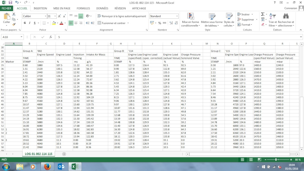

Voici mes logs, qu'en pensez vous ?
LOG-01-002-031-xxx.CSV LOG-01-114-115-xxx.CSV LOG-01-010-020-xxx.CSV LOG-01-020-120-xxx.CSV
