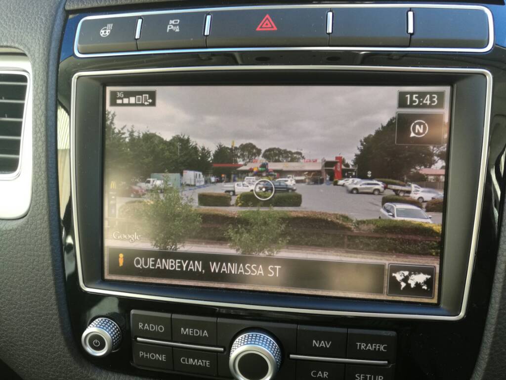

Hello I am from the UK and I have a 2016 Treg with the RNS 850 installed (with SIM slot) and with working Google Maps / Live Traffic from the factory.
Miazza kindly pointed me to the great work you have done here and I hope you can help me with my problem.
Like everyone with the RNS 850 and SIM, as soon as you install a SIM the device disconnects the bluetooth telephone connection. It seems Audi was able to correct this issue over 2 years ago but VW remains very much behind.
I would like to be able to use Google either with the SIM installed or by using the iPhone as a hotspot to provide the data connection and without disconnecting the bluetooth telephone connection. I think this is what Windstar has already done but due to some translation problems for me I cannot exactly determine the steps followed, perhaps you can help with a simple and straight forward list of actions.

I did exactly as suggested.
My IP configguration from Green menu is the following (copioed from pic):
----IP configuration----------------
[iNFO]_CS_RESOLVE:
[iNFO] /etc/resolv.conf:
nameserver 8.8.8.8 nameserver 8.8.4.4
----Routing table-------------------
Destination Gateway Flags
default 192.168.2.1 UG
192.168.0.0/16 192.168.2.1 UG
192.168.1.1 (MAC RNS) UHL
192.168.1.110 (MAC RNS) UHL
192.168.2.1 (MAC ROUTER) UHL
239.255.255.250/32 192.168.1.1 UG
I think I have internet access in RNS but Google Services are graied out ... I guess there is a special setting to be saved in the DataPST.db but this must be specific for systems without SIM (like what windstar did for his system with SIM).
May be NOY knows something more on this.

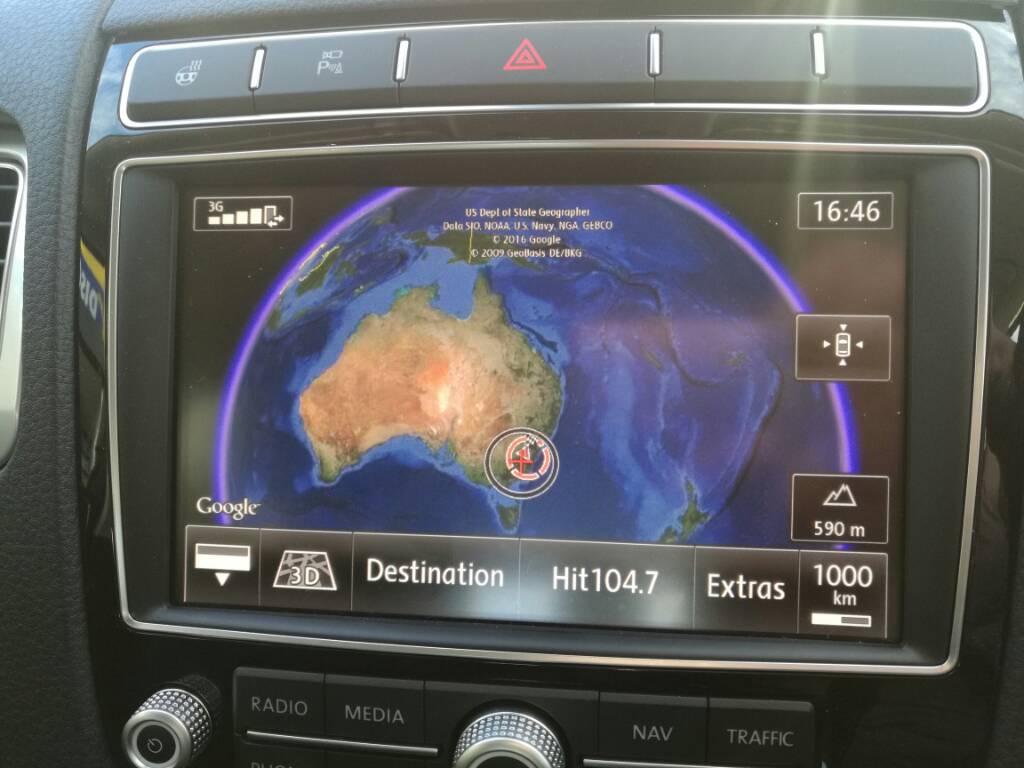

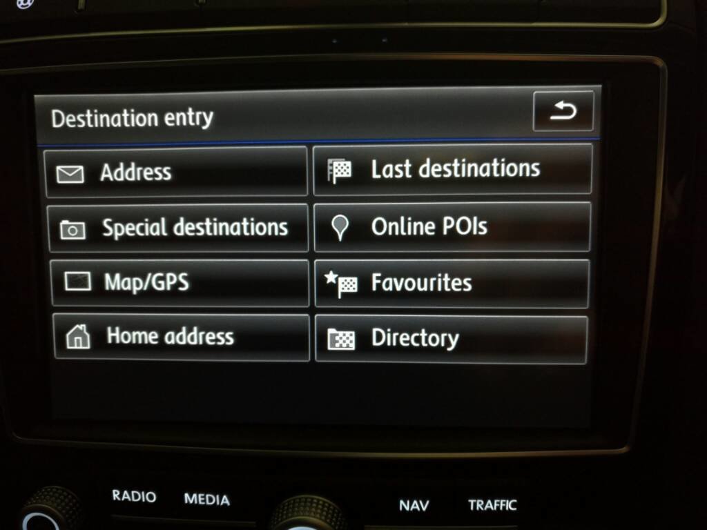

Hello to everybody.
With the assistance of congo (many thanks to him again), I have succeded to activate GE on my RNS850 without using third parties DataDSP.db.
In order to summarize the job done, starting from the great tutorial of this discussion, I have written a tutorial tailored to Touareg RNS850 system.
You can find it at the following link, together with all the scripts that are necessary for the install and GE activation.
https://mega.nz/#!5o1nkKKQ!b8jzDpFQBcJ1MskB-9MxaHlBGXBMzy0tw4e2Cak-NXY
I hope this is useful.

You need K0821 in order GE to work. But i don't have AN map so use at own risk :)
Second - why you are using the Odi WIFI scripts when you have SIM ... not the same.
For car with SIM you only need 02 - RNS850-GE_ENABLE but that will work on RNS units with K0821/2 soft.
Can we update just the SW to K0821 without disturbing the maps?
Sent from my HUAWEI NXT-AL10 using Tapatalk
Cant tell you. Don't have such MAP in hand to try :(
That's fine. Thanks for your replies though.
BTW I've got Google Earth working on my unit with same maps.
Will work on maps to find the latest one. Will maybe require help for activation solution for public.
post-139718-14712634002401_thumb.jpgpost-139718-1471263447983_thumb.jpgpost-139718-14712635014147_thumb.jpg
Cool, glad that it worked for you :)
If you do find the map please share.
As for the activator. the one for the EU maps should for for AN map too ;)
