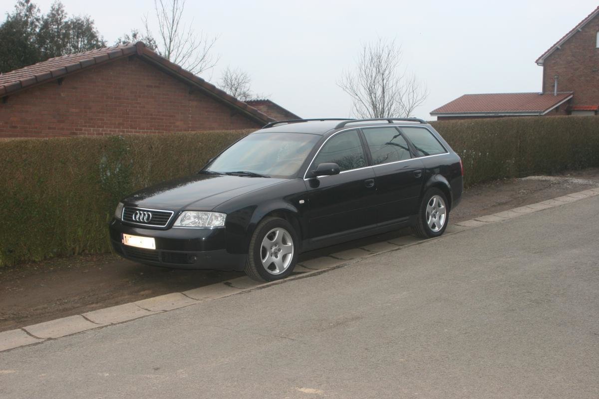

Mon Audi A6 2.5L TDI V6 Quattro Break 180cv Tiptronic
