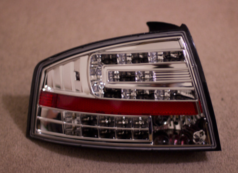

I decided to have a go modifying the rear lights.

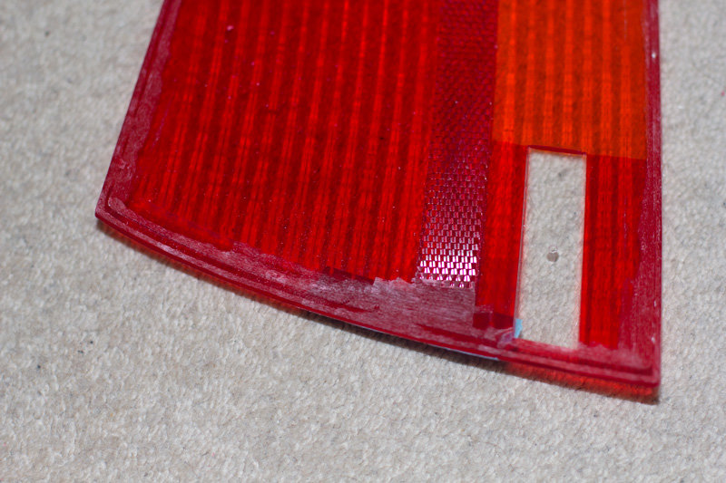

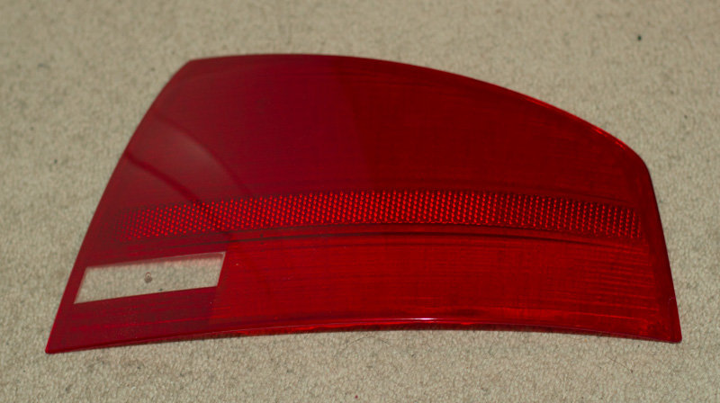

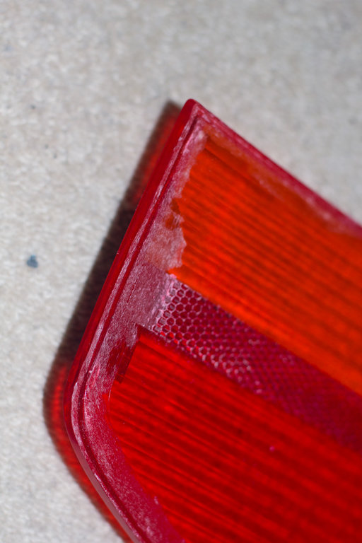

I chopped the lenses off the original OEM ones with the Dremel:

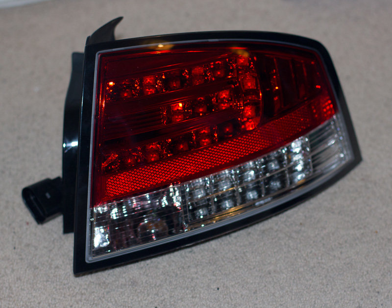

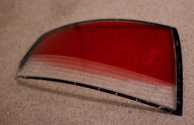

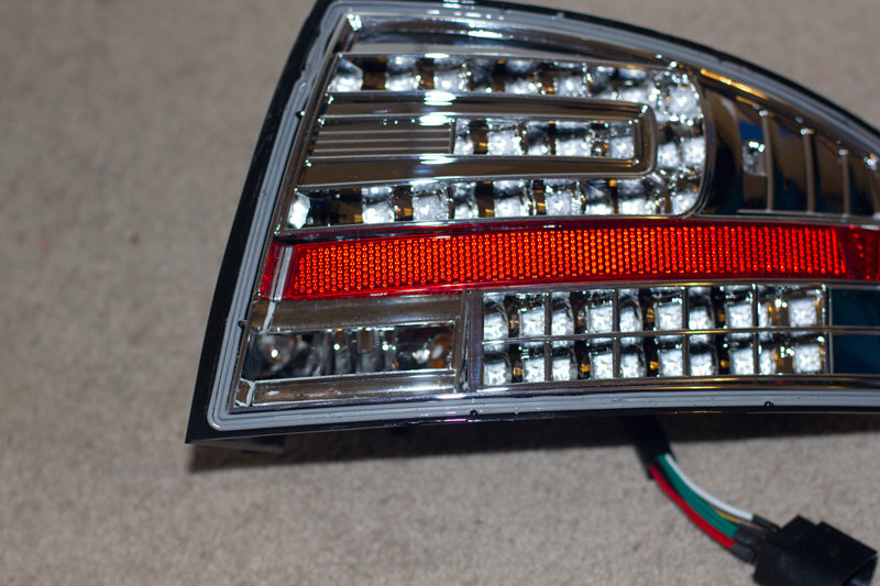

Then I heated up the LED ones and prised the lenses off:
The reflector section of the original lens interfered with the chrome housing, so I ground it down:
Here's the lens held in place with blutac:

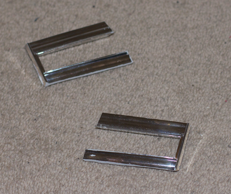

And I took the reversing light housing section from the OEM lights & cut it to fit:
I've since been flatting back and polishing up the edges of the lenses, which is a dull process!

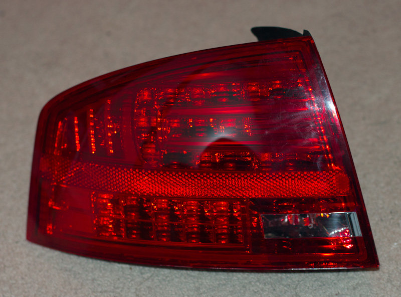

I trial fitted one of the lights back in the car with it's new lens to check the fitment - the original lens is larger than the one that the new lights came with and it's just a case of playing around with it until it sits flush. The light fittings which pop into the wing are slightly too proud and causing a gap, so I'm trying to figure out a way of solving this...
