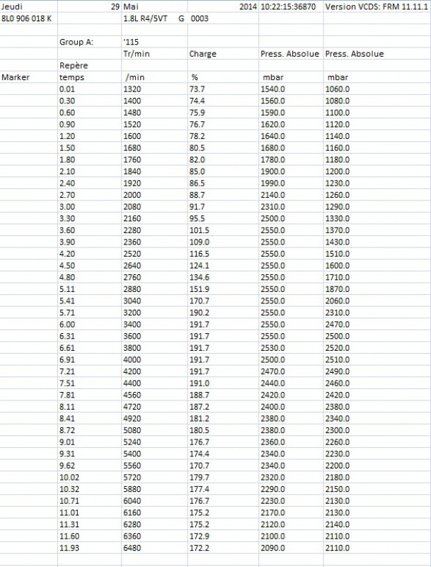

en esperant que soit plus lisible:
Débimètre
Jeudi 29 Mai 2014 10:24:21:36870 Version VCDS: FRM 11.11.1 8L0 906 018 K 1.8L R4/5VT G 0003 Group A: '002 Tr/min Charge Temps d'injec. Débit massique Repère Marker temps /min % ms g/s 0.01 1640 76.7 7.38 25.03 0.30 1720 78.2 7.79 26.83 0.60 1800 82.0 7.79 29.00 0.90 1880 85.0 8.20 31.89 1.20 1960 88.7 8.20 34.58 1.50 2080 90.2 8.61 37.08 1.80 2160 97.0 9.02 42.56 2.11 2280 103.8 9.84 47.56 2.40 2400 112.0 10.25 53.72 2.70 2520 121.1 11.48 60.44 3.01 2640 130.8 12.30 69.14 3.30 2760 145.9 13.53 81.61 3.61 2920 163.2 15.17 97.78 3.91 3120 184.2 16.81 116.06 4.31 3360 191.7 18.04 130.08 4.61 3560 191.7 17.63 134.42 5.01 3840 191.0 17.22 140.78 5.33 4040 191.7 17.22 148.56 5.71 4280 191.7 18.04 156.28 6.02 4480 189.5 18.45 160.56 6.41 4760 186.5 18.45 169.28 6.71 4920 181.2 18.04 169.94 7.01 5080 178.9 18.04 172.61 7.32 5240 176.7 18.04 176.31 7.61 5400 185.7 20.09 178.39 7.91 5560 184.2 20.50 181.61 8.21 5680 182.0 20.50 181.11 8.52 5840 182.0 20.91 184.50 8.91 6000 181.2 22.14 185.11 9.21 6120 180.5 23.37 188.25 9.52 6240 178.2 22.55 188.56 9.91 6360 178.2 22.55 188.11 10.21 6480 175.2 22.96 190.14 10.51 6600 174.4 22.55 189.31 10.80 6680 172.9 22.55 186.92 11.11 6800 172.2 22.14 188.11 11.42 6880 172.9 22.96
187.92
Turbo
Jeudi 29 Mai 2014 10:22:15:36870 Version VCDS: FRM 11.11.1 8L0 906 018 K 1.8L R4/5VT G 0003 Group A: '115 Tr/min Charge Press. Absolue Press. Absolue Repère Marker temps /min % mbar mbar 0.01 1320 73.7 1540.0 1060.0 0.30 1400 74.4 1560.0 1080.0 0.60 1480 75.9 1590.0 1100.0 0.90 1520 76.7 1620.0 1120.0 1.20 1600 78.2 1640.0 1140.0 1.50 1680 80.5 1680.0 1160.0 1.80 1760 82.0 1780.0 1180.0 2.10 1840 85.0 1900.0 1200.0 2.40 1920 86.5 1990.0 1230.0 2.70 2000 88.7 2140.0 1260.0 3.00 2080 91.7 2310.0 1290.0 3.30 2160 95.5 2500.0 1330.0 3.60 2280 101.5 2550.0 1370.0 3.90 2360 109.0 2550.0 1430.0 4.20 2520 116.5 2550.0 1510.0 4.50 2640 124.1 2550.0 1600.0 4.80 2760 134.6 2550.0 1710.0 5.11 2880 151.9 2550.0 1870.0 5.41 3040 170.7 2550.0 2060.0 5.71 3200 190.2 2550.0 2310.0 6.00 3400 191.7 2550.0 2470.0 6.31 3600 191.7 2550.0 2500.0 6.61 3800 191.7 2530.0 2520.0 6.91 4000 191.7 2500.0 2510.0 7.21 4200 191.7 2470.0 2490.0 7.51 4400 191.0 2440.0 2460.0 7.81 4560 188.7 2420.0 2420.0 8.11 4720 187.2 2400.0 2380.0 8.41 4920 181.2 2380.0 2340.0 8.72 5080 180.5 2380.0 2300.0 9.01 5240 176.7 2360.0 2260.0 9.31 5400 174.4 2340.0 2230.0 9.62 5560 170.7 2340.0 2200.0 10.02 5720 179.7 2320.0 2180.0 10.32 5880 177.4 2290.0 2150.0 10.71 6040 176.7 2230.0 2130.0 11.01 6160 175.2 2170.0 2130.0 11.31 6280 175.2 2120.0 2140.0 11.60 6360 172.9 2100.0 2110.0 11.93 6480 172.2 2090.0 2110.0
Arf c'est pas encore ça, en fait moi je fais la procédure expliquée sur le lien que je t'es filé et ensuite je fais un imprime écran pour coller sur un fichier paint, je sauvegarde le fichier en jpeg et j'héberge la photo sur photobucket (où il faut créer ton compte, c'est gratuit) une fois la photo hébergée, tu ouvre ses paramètres et tu copie le lien prévu pour les forums, puis tu colle ce dernier dans ton texte où tu veux faire apparaître la photo, ce qui te donne ça:
Si tu n'y arrives pas, contacte moi par MP, je t'expliquerai mieux!!
Même joueur joue encore !!! :mur:
c'est mieu la?
c'est mieux....

je te confirme que ton débitmetre est faiblard jeje exactement comme ce que j'avais avec un débitmetre neuf, ou je montais juste 192g...
apres tes valeurs pression turbo suivent a peu près la consigne,donc selon moi, la pression ne chute pas dans les tours comme je pouvais l'avoir sur la mienne qui étais fissurée de partout.
j'émets un edit car j'ai vu tes autres logs turbo au dessus et on voit que certains ne suivent pas la consigne et ta pression chute dans les tours...
je ne veux pas te faire peur mais mes logs avec mes 15 fissures donnaient la meme chose.....
Ceci dit, as tu pu faire un log moteur bien chaud apres avoir bien roulé et moteur à peine chaud pour voir s'il y a des pertes de pression? car une culasse ou turbo/collecteur fissurés, ta pression sera bonne au premier run et sur les suivants avec la dilatation ta pression chutera, ce serait bien de comparer les deux. pour ma part, c'est aussi pour ça que mon débitmetre ne donnait pas assez.
car on a souvent tendance à lire des valeurs débitmetre faiblarde et à changer celui ci alors qu'il est neuf et que le soucis ne vient pas de la.
donc ta voiture est reprog, c'est cur, ceci dit (et BK pourra nous en dire plus)je suis sceptique sur ton mano de pression car si je ne m'abuse, il ne donne pas non plus la pression absolue puisqu'elle devrait donner approximativement 2.4/2.5 bar en charge si c'était le cas et pas 1.9 bar nan?
Modifié par toplads
sur ces 2.4, 2.5b faut enlever la pression atmosphérique (environ 1b) donc pour moi ton mano ne donne pas la bonne pression....
oui geo, ce que je voulais dire,c'est que si son mano donnait par malheur la pression absolue et pas relative, ça ne concorderait pas de toute façon car il devrait afficher environ 2.5bars en charge.

et nan pas du tout identiques tes logs jeje, mon petit doigt me dit que ceux faits à froid te donne un résultat qui suit la consigne et que ceux fait à chaud sont ceux qui ne la suivent pas.
par exemple dans celui que tu as reporté sur tableau excel, la consigne est suivie et aucun probleme pour moi.
par contre les tous premiers que tu a posté, tu as toujours entre 100 et 200g de perte par rapport à la consigne ce qui veut dire qu'il y a bien un soucis à chaud....et c'est pas forcément bon signe
