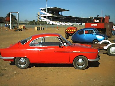

- Prinz sport
user posted image

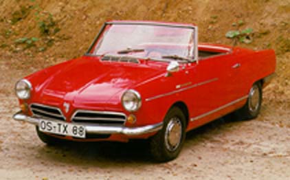

-Prinz spyder
user posted image
