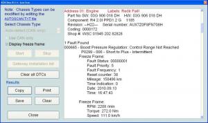

Alors voici le résultat du scan :
00-Steering Angle Sensor -- Status: OK 0000
01-Engine -- Status: Malfunction 0010
03-ABS Brakes -- Status: OK 0000
08-Auto HVAC -- Status: OK 0000
09-Cent. Elect. -- Status: OK 0000
15-Airbags -- Status: OK 0000
16-Steering wheel -- Status: OK 0000
17-Instruments -- Status: OK 0000
19-CAN Gateway -- Status: OK 0000
22-AWD -- Status: OK 0000
25-Immobilizer -- Status: OK 0000
42-Door Elect, Driver -- Status: OK 0000
44-Steering Assist -- Status: OK 0000
46-Central Conv. -- Status: Malfunction 0010
47-Sound System -- Status: OK 0000
52-Door Elect, Pass. -- Status: OK 0000
56-Radio -- Status: OK 0000
76-Park Assist -- Status: OK 0000
77-Telephone -- Status: OK 0000
7D-Aux. Heat -- Status: OK 0000
Address 01: Engine Labels: Redir Fail!
Part No SW: 03G 906 018 DH HW: 03G 906 018 DH
Component: R4 2.0l PPD1.2 G 1185
Revision: --H22--- Serial number: AUX7Z0F8FN708H
Coding: 0000172
Shop #: WSC 01945 202 82828
1 Fault Found
000665 - Boost Pressure Regulation: Control Range Not Reached
P0299 - 006 - Short to Plus - Intermittent
Freeze Frame:
Fault Status: 00000001
Fault Priority: 5
Fault Frequency: 1
Reset counter: 38
Mileage: 158496 km
Time Indication: 0
Date: 2010.09.13
Time: 16:47:43
Freeze Frame:
RPM: 2208 /min
Torque: 272.0 Nm
Speed: 111.0 km/h
99.45 %
Voltage: 14.13 V
Pressure: 2428.2 mbar
Pressure: 1618.8 mbar
Readiness: N/A
Address 46: Central Conv. Labels: 8P0-959-433.lbl
Part No: 8P0 959 433 C
Component: KSG H04 0050
Coding: 188000186D288505488AC67300
Shop #: WSC 06314 000 00000
Part No: 1K0 951 605 C
Component: LIN BACKUP HORN H03 1301
Part No: 1K0 907 719 C
Component: Neigungssensor 005 0003
Part No: 8P0 951 177
Component: Innenraumueberw.H04 0020
1 Fault Found
00332 - Control Circuit for Tank Flap
007 - Short to Ground - Intermittent
Modifié par audiquattro..

pour le diag je retombe toujours sur la meme erreur et la voici
09-Cent. Elect. -- Status: Malfunction 0010
Coding: 0000172
4 Faults Found
Freeze Frame:
Fault Priority: 5
Fault Frequency: 1
Reset counter: 29
Mileage: 158496 km
Time Indication: 0
Date: 2010.09.13
Time: 16:47:43
Freeze Frame:
RPM: 2208 /min
Torque: 272.0 Nm
Speed: 111.0 km/h
99.45 %
Voltage: 14.13 V
000258 - Mass Air Flow Sensor (G70): Signal too Low
P0102 - 007 - Short to Ground - Intermittent
Freeze Frame:
Fault Status: 00000010
Fault Priority: 5
Fault Frequency: 1
Reset counter: 37
Mileage: 158678 km
Time Indication: 0
Date: 2010.09.20
Time: 17:00:12
Freeze Frame:
RPM: 800 /min
Torque: 40.0 Nm
Speed: 0.0 km/h
0.00 %
Voltage: 14.13 V
Mass Air / Rev.: 256.1 mg/str
Mass Air / Rev.: 0.0 mg/str
008825 - Leak in Air Intake System
P2279 - 006 - Short to Plus - Intermittent
Freeze Frame:
Fault Priority: 5
Fault Frequency: 6
Reset counter: 38
Mileage: 158693 km
Time Indication: 0
Date: 2010.09.20
Time: 20:07:04
Freeze Frame:
RPM: 2048 /min
Torque: 320.0 Nm
Speed: 50.0 km/h
Pressure: 2108.7 mbar
Pressure: 1256.7 mbar
(no units): 0.61
Text: Kein Messw
000257 - Mass Air Flow Sensor (G70): Implausible Signal
P0101 - 006 - Short to Plus - Intermittent
Freeze Frame:
Fault Priority: 1
Fault Frequency: 1
Reset counter: 38
Mileage: 158696 km
Time Indication: 0
Date: 2010.09.20
Time: 20:26:27
Freeze Frame:
Text: ert verfue
Text: gbar
Speed: 41.0 km/h
Temperature: 39.0°C
Pressure: 1001.1 mbar
Text: 92
Text: kg/h
Readiness: N/A
