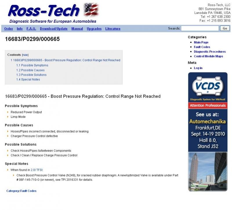

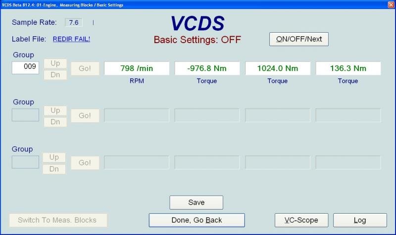

pour le diag je retombe toujours sur la meme erreur et la voici 00-Steering Angle Sensor -- Status: OK 0000 01-Engine -- Status: Malfunction 0010 03-ABS Brakes -- Status: OK 0000 08-Auto HVAC -- Status: OK 0000 09-Cent. Elect. -- Status: Malfunction 0010 15-Airbags -- Status: OK 0000 16-Steering wheel -- Status: OK 0000 17-Instruments -- Status: OK 0000 19-CAN Gateway -- Status: OK 0000 22-AWD -- Status: OK 0000 25-Immobilizer -- Status: OK 0000 42-Door Elect, Driver -- Status: OK 0000 44-Steering Assist -- Status: OK 0000 46-Central Conv. -- Status: Malfunction 0010 47-Sound System -- Status: OK 0000 52-Door Elect, Pass. -- Status: OK 0000 56-Radio -- Status: OK 0000 76-Park Assist -- Status: OK 0000 77-Telephone -- Status: OK 0000 7D-Aux. Heat -- Status: OK 0000 ------------------------------------------------------------------------------- Address 01: Engine Labels: Redir Fail! Part No SW: 03G 906 018 DH HW: 03G 906 018 DH Component: R4 2.0l PPD1.2 G 1185 Revision: --H22--- Serial number: AUX7Z0F8FN708H Coding: 0000172 Shop #: WSC 01945 202 82828 4 Faults Found 000665 - Boost Pressure Regulation: Control Range Not Reached P0299 - 006 - Short to Plus - Intermittent Freeze Frame: Fault Status: 00000001 Fault Priority: 5 Fault Frequency: 1 Reset counter: 29 Mileage: 158496 km Time Indication: 0 Date: 2010.09.13 Time: 16:47:43 Freeze Frame: RPM: 2208 /min Torque: 272.0 Nm Speed: 111.0 km/h 99.45 % Voltage: 14.13 V Pressure: 2428.2 mbar Pressure: 1618.8 mbar 000258 - Mass Air Flow Sensor (G70): Signal too Low P0102 - 007 - Short to Ground - Intermittent Freeze Frame: Fault Status: 00000010 Fault Priority: 5 Fault Frequency: 1 Reset counter: 37 Mileage: 158678 km Time Indication: 0 Date: 2010.09.20 Time: 17:00:12 Freeze Frame: RPM: 800 /min Torque: 40.0 Nm Speed: 0.0 km/h 0.00 % Voltage: 14.13 V Mass Air / Rev.: 256.1 mg/str Mass Air / Rev.: 0.0 mg/str 008825 - Leak in Air Intake System P2279 - 006 - Short to Plus - Intermittent Freeze Frame: Fault Status: 00000001 Fault Priority: 5 Fault Frequency: 6 Reset counter: 38 Mileage: 158693 km Time Indication: 0 Date: 2010.09.20 Time: 20:07:04 Freeze Frame: RPM: 2048 /min Torque: 320.0 Nm Speed: 50.0 km/h Pressure: 2108.7 mbar Pressure: 1256.7 mbar (no units): 0.61 Text: Kein Messw 000257 - Mass Air Flow Sensor (G70): Implausible Signal P0101 - 006 - Short to Plus - Intermittent Freeze Frame: Fault Status: 00000001 Fault Priority: 1 Fault Frequency: 1 Reset counter: 38 Mileage: 158696 km Time Indication: 0 Date: 2010.09.20 Time: 20:26:27 Freeze Frame: Text: ert verfue Text: gbar Speed: 41.0 km/h Temperature: 39.0°C Pressure: 1001.1 mbar Text: 92 Text: kg/h Readiness: N/A t'en pense quoi
voila aujourd'hui on a fait le diag avec vag com avec un ami que je salut au passage :jap: :jap: :coucou: :coucou: :coucou: et bon on a trouver plusieurs défaut mais en faite a cause de moi car j'avais en lever les fusible pour les contrôler donc ça ma marquer plein de défaut qui ne le sont pas en vrai :carre: mais celui qui nous intéressé c'est le défaut moteur mais que j'avais essayer de rouler sans débitmètre et par la suite j'en ai mis un neuf de débitmètre, on a effacé les défaut je suis parti et en rentrant chez moi je pousse la 3 puis je met la 4 et la coupure avec le voyant de préchauffage qui clignote la misère j'en ai marre de cette caisse sérieux :hot: <_< :exclamation: :bleble: :colere: :furious:
je vais faire un autre diag aujourd'hui je vous tiens informer

Alors voici le résultat du scan : 00-Steering Angle Sensor -- Status: OK 0000 01-Engine -- Status: Malfunction 0010 03-ABS Brakes -- Status: OK 0000 08-Auto HVAC -- Status: OK 0000 09-Cent. Elect. -- Status: OK 0000 15-Airbags -- Status: OK 0000 16-Steering wheel -- Status: OK 0000 17-Instruments -- Status: OK 0000 19-CAN Gateway -- Status: OK 0000 22-AWD -- Status: OK 0000 25-Immobilizer -- Status: OK 0000 42-Door Elect, Driver -- Status: OK 0000 44-Steering Assist -- Status: OK 0000 46-Central Conv. -- Status: Malfunction 0010 47-Sound System -- Status: OK 0000 52-Door Elect, Pass. -- Status: OK 0000 56-Radio -- Status: OK 0000 76-Park Assist -- Status: OK 0000 77-Telephone -- Status: OK 0000 7D-Aux. Heat -- Status: OK 0000 ------------------------------------------------------------------------------- Address 01: Engine Labels: Redir Fail! Part No SW: 03G 906 018 DH HW: 03G 906 018 DH Component: R4 2.0l PPD1.2 G 1185 Revision: --H22--- Serial number: AUX7Z0F8FN708H Coding: 0000172 Shop #: WSC 01945 202 82828 1 Fault Found 000665 - Boost Pressure Regulation: Control Range Not Reached P0299 - 006 - Short to Plus - Intermittent Freeze Frame: Fault Status: 00000001 Fault Priority: 5 Fault Frequency: 1 Reset counter: 38 Mileage: 158496 km Time Indication: 0 Date: 2010.09.13 Time: 16:47:43 Freeze Frame: RPM: 2208 /min Torque: 272.0 Nm Speed: 111.0 km/h 99.45 % Voltage: 14.13 V Pressure: 2428.2 mbar Pressure: 1618.8 mbar Readiness: N/A ------------------------------------------------------------------------------- Address 46: Central Conv. Labels: 8P0-959-433.lbl Part No: 8P0 959 433 C Component: KSG H04 0050 Coding: 188000186D288505488AC67300 Shop #: WSC 06314 000 00000 Part No: 1K0 951 605 C Component: LIN BACKUP HORN H03 1301 Part No: 1K0 907 719 C Component: Neigungssensor 005 0003 Part No: 8P0 951 177 Component: Innenraumueberw.H04 0020 1 Fault Found 00332 - Control Circuit for Tank Flap 007 - Short to Ground - Intermittent -------------------------------------------------------------------------------
