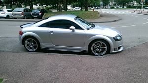

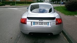

Voila ma belle en photo jointe :malelovies: post-116400-0-10278600-1405973597.jpgpost-116400-0-63587800-1405973609.jpg
