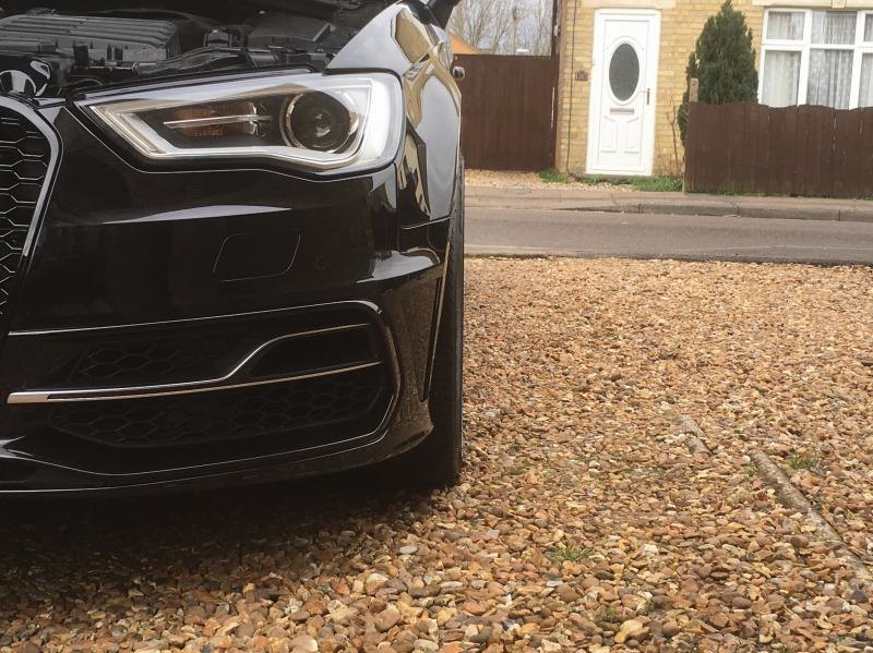

2020_07_02_14_23_53_811EF1AA-8EE9-4457-8
2020_06_15_12_35_54_repliques-rotor-2.pn
