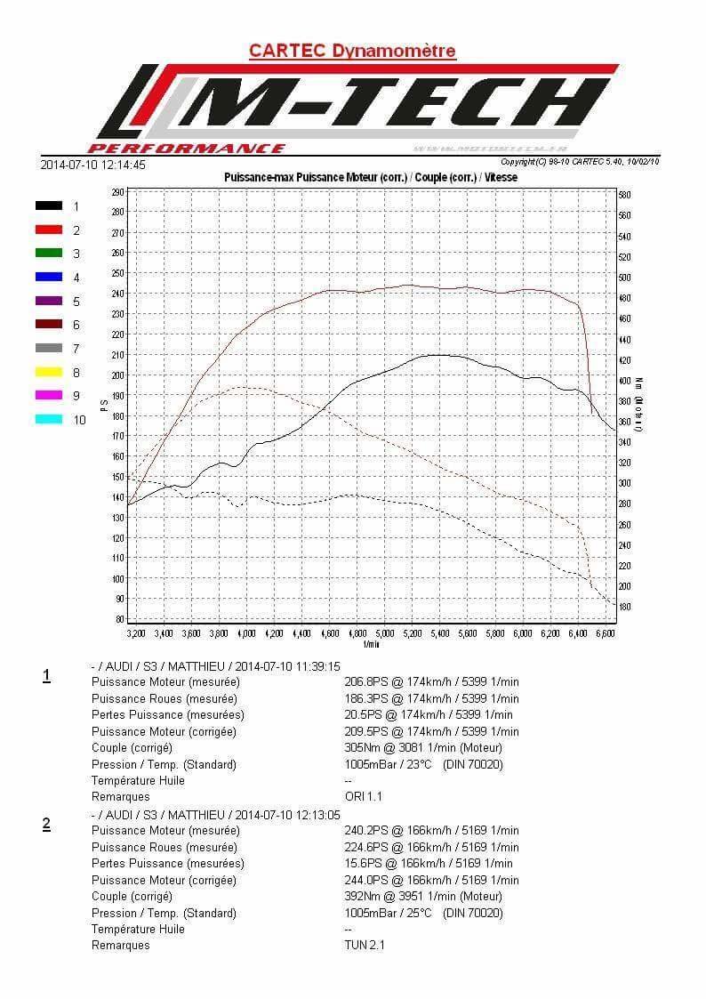

Du coup je l'ai est tous refait pour être tranquille. Il y a bien tout ce que tu as besoin Soldjah ? Tu vois un truc pas normal par rapport a mes accoup en pleine charge ? Dimanche,09,Avril,2017,14:38:50 8N0 906 018 J,,1.8L R4/5VT G 0004, ,Groupe A:,'002,,,,Groupe B:,'115,,,,Groupe C:, Non actif ,,Tr/min,Charge,Temps d'injec.,Débit massique,,Tr/min,Charge,Press. Absolue,Press. Absolue,,,,, ,Repère,,,,,Repère,,,,,Repère,,,, Marqueur,temps, /min, %, ms, g/s,temps, /min, %, mbar, mbar,temps,,,, ,0.03,3080,26.3,2.72,15.50,0.30,3080,26.3,920.0,950.0,,,,, ,0.60,3080,26.3,2.72,15.81,0.90,3160,69.2,1850.0,910.0,,,,, ,1.20,3280,92.5,8.84,67.64,1.51,3520,123.3,2350.0,1420.0,,,,, ,1.81,3800,161.7,14.28,135.78,2.11,4160,191.7,2320.0,2310.0,,,,, ,2.41,4560,191.7,18.02,170.42,2.71,4960,187.2,2310.0,2230.0,,,,, ,3.01,5320,181.2,16.66,180.61,3.33,5640,172.9,2100.0,2080.0,,,,, ,3.62,5960,171.4,15.30,190.83,3.93,6280,161.7,1840.0,1990.0,,,,, ,4.22,6520,154.1,13.60,188.36,4.54,6680,106.0,920.0,2060.0,,,,, ,5.45,6480,12.8,1.36,13.08,5.73,6400,12.8,920.0,1020.0,,,,, ,6.03,6320,12.8,1.36,15.92,6.33,6240,12.0,920.0,990.0,,,,, ,6.64,6160,12.0,0.00,14.75,6.95,6040,12.0,920.0,970.0,,,,, ,32.58,3480,106.8,9.86,84.22,32.28,3320,76.7,1510.0,1020.0,,,,, ,33.19,4120,185.7,16.32,163.67,32.88,3760,143.6,2360.0,1680.0,,,,, ,33.79,4960,188.7,17.34,174.25,33.49,4520,191.7,2310.0,2350.0,,,,, ,34.39,5640,173.7,15.98,187.75,34.09,5320,180.5,2230.0,2120.0,,,,, ,35.00,6280,158.6,13.94,193.00,34.69,6000,170.7,1910.0,2010.0,,,,, ,35.61,6800,122.6,9.86,150.81,35.31,6520,142.9,1670.0,2020.0,,,,, ,36.20,6760,12.8,1.36,8.97,35.91,6760,22.6,910.0,1440.0,,,,, ,60.35,3120,81.2,7.82,55.33,60.64,3280,105.3,2060.0,1240.0,,,,, ,60.96,3520,137.6,12.24,108.94,61.25,3800,177.4,2330.0,2100.0,,,,, ,61.55,4160,191.7,18.02,163.86,61.85,4560,191.7,2300.0,2330.0,,,,, ,62.15,4960,187.2,16.66,174.25,62.45,5280,180.5,2230.0,2160.0,,,,, ,62.76,5600,175.2,15.30,187.44,63.06,5880,169.9,1960.0,1990.0,,,,, ,63.36,6120,164.7,14.28,191.78,63.67,6400,153.4,1400.0,1940.0,,,,, ,63.96,6440,38.3,3.06,6.81,64.26,6360,12.0,910.0,1240.0,,,,, ,64.57,6280,12.8,1.36,10.53,64.87,6200,12.8,910.0,1050.0,,,,, Dimanche,09,Avril,2017,14:41:10 8N0 906 018 J,,1.8L R4/5VT G 0004, ,Groupe A:,'002,,,,Groupe B:,'115,,,,Groupe C:, Non actif ,,Tr/min,Charge,Temps d'injec.,Débit massique,,Tr/min,Charge,Press. Absolue,Press. Absolue,,,,, ,Repère,,,,,Repère,,,,,Repère,,,, Marqueur,temps, /min, %, ms, g/s,temps, /min, %, mbar, mbar,temps,,,, ,4.51,2920,94.7,8.84,61.33,4.80,3000,119.5,2310.0,1390.0,,,,, ,5.10,3120,145.1,14.62,97.81,5.40,3240,173.7,2340.0,2060.0,,,,, ,5.70,3440,191.7,20.40,143.17,6.01,3600,191.7,2330.0,2520.0,,,,, ,6.31,3800,191.7,22.44,148.19,6.61,3960,191.7,2330.0,2460.0,,,,, ,6.91,4160,191.7,20.74,160.11,7.21,4320,191.7,2310.0,2400.0,,,,, ,7.51,4480,191.7,20.06,166.64,7.82,4680,190.2,2300.0,2310.0,,,,, ,8.12,4840,186.5,19.04,172.33,8.42,4960,184.2,2300.0,2180.0,,,,, ,8.72,5120,183.5,18.02,177.67,9.02,5280,176.7,2230.0,2130.0,,,,, ,9.32,5440,178.2,17.68,184.11,9.63,5560,175.2,2170.0,2080.0,,,,, ,9.93,5720,175.2,17.68,186.53,10.24,5880,171.4,2100.0,2010.0,,,,, ,10.53,6000,161.7,16.32,190.83,10.83,6120,160.9,2050.0,2050.0,,,,, ,11.13,6240,160.9,15.98,192.56,11.44,6360,156.4,1920.0,1970.0,,,,, ,11.74,6480,152.6,16.66,190.61,12.04,6600,147.4,1330.0,2020.0,,,,, ,12.34,6600,39.8,4.08,13.72,12.64,6480,12.0,910.0,1230.0,,,,, ,12.95,6480,12.8,1.70,12.36,13.25,6440,12.8,910.0,1040.0,,,,, ,23.20,3320,133.1,12.92,98.86,22.90,3200,102.3,2340.0,1220.0,,,,, ,23.81,3720,191.7,19.38,153.14,23.50,3520,169.2,2340.0,2000.0,,,,, ,24.41,4120,191.7,20.40,157.61,24.11,3920,191.7,2330.0,2480.0,,,,, ,25.01,4520,191.7,20.06,168.25,24.71,4320,191.7,2310.0,2390.0,,,,, ,25.62,4880,188.0,19.38,175.47,25.32,4680,191.7,2300.0,2270.0,,,,, ,26.22,5200,182.7,19.04,175.94,25.92,5040,184.2,2280.0,2210.0,,,,, ,26.82,5520,174.4,18.70,184.42,26.52,5360,178.2,2230.0,2120.0,,,,, ,27.43,5800,168.4,18.02,189.58,27.12,5680,175.9,2140.0,2030.0,,,,, ,28.03,6080,166.2,18.02,192.39,27.73,5960,166.2,2080.0,2020.0,,,,, ,28.64,6320,162.4,17.68,191.00,28.33,6200,158.6,2030.0,2000.0,,,,, ,29.24,6520,151.1,17.00,190.53,28.94,6440,154.1,2000.0,1970.0,,,,, ,29.84,6720,149.6,17.68,192.39,29.55,6640,153.4,1970.0,1940.0,,,,, ,30.45,6720,68.4,6.80,12.42,30.14,6800,147.4,1890.0,2000.0,,,,, ,41.32,3040,114.3,11.22,77.53,41.62,3160,138.3,2340.0,1650.0,,,,, ,41.91,3320,166.9,16.32,118.50,42.21,3480,191.7,2330.0,2390.0,,,,, ,42.50,3640,191.7,21.08,148.28,42.82,3840,191.7,2310.0,2510.0,,,,, ,43.12,4040,191.7,20.74,152.56,43.42,4240,191.7,2300.0,2400.0,,,,, ,43.72,4400,191.7,20.06,161.33,44.02,4560,191.0,2280.0,2330.0,,,,, ,44.32,4760,187.2,19.38,168.25,44.63,4920,185.7,2280.0,2230.0,,,,, ,44.93,5080,182.7,19.04,175.94,45.23,5240,179.7,2230.0,2130.0,,,,, ,45.53,5360,173.7,18.36,179.86,45.83,5520,174.4,2160.0,2110.0,,,,, ,46.13,5680,172.2,18.70,185.31,46.44,5800,169.2,2100.0,2070.0,,,,, ,46.74,5920,164.7,17.34,188.36,47.04,6040,163.9,2040.0,2040.0,,,,, ,47.34,6160,158.6,16.66,189.28,47.64,6240,154.1,2020.0,2010.0,,,,, ,47.94,6360,155.6,17.34,189.92,48.25,6480,152.6,1980.0,2000.0,,,,, ,48.55,6560,148.9,16.66,190.53,48.85,6560,36.8,910.0,1820.0,,,,, ,49.16,6480,12.0,1.70,3.81,49.46,6400,12.8,910.0,1110.0,,,,, Lundi,10,Avril,2017,15:24:00 8N0 906 018 J,,1.8L R4/5VT G 0004, ,Groupe A:,'002,,,,Groupe B:,'115,,,,Groupe C:, Non actif ,,Tr/min,Charge,Temps d'injec.,Débit massique,,Tr/min,Charge,Press. Absolue,Press. Absolue,,,,, ,Repère,,,,,Repère,,,,,Repère,,,, Marqueur,temps, /min, %, ms, g/s,temps, /min, %, mbar, mbar,temps,,,, ,0.05,2360,119.5,12.24,57.14,0.34,2480,133.1,2310.0,1600.0,,,,, ,0.67,2600,146.6,15.30,79.33,0.96,2760,163.2,2360.0,1940.0,,,,, ,1.30,2880,183.5,19.04,112.50,1.67,3120,191.7,2390.0,2500.0,,,,, ,2.04,3360,191.7,22.78,135.50,2.34,3560,191.7,2390.0,2540.0,,,,, ,2.65,3760,191.7,22.10,151.50,2.95,3960,191.7,2390.0,2440.0,,,,, ,3.25,4160,191.7,20.74,159.78,3.55,4320,191.7,2370.0,2400.0,,,,, ,3.88,4480,191.7,20.40,169.47,4.15,4640,191.7,2360.0,2310.0,,,,, ,4.47,4800,189.5,19.38,173.28,4.80,4960,187.2,2360.0,2170.0,,,,, ,5.16,5160,180.5,18.70,178.89,5.46,5280,182.0,2290.0,2110.0,,,,, ,5.79,5440,181.2,19.38,187.39,6.07,5560,179.7,2230.0,2090.0,,,,, ,6.38,5720,178.2,19.38,190.72,6.68,5840,171.4,2170.0,2090.0,,,,, ,7.03,5920,168.4,18.36,193.94,7.37,6080,169.2,2110.0,2050.0,,,,, ,7.69,6200,163.2,17.68,196.78,7.97,6280,166.9,2080.0,1970.0,,,,, ,8.29,6400,163.9,17.68,196.47,8.58,6520,160.2,2000.0,2020.0,,,,, ,8.96,6600,160.2,17.34,198.06,9.30,6720,158.6,1920.0,2160.0,,,,, ,9.61,6800,145.1,15.98,185.61,9.90,6800,35.3,940.0,1740.0,,,,, ,32.54,2120,94.0,9.52,41.31,32.82,2240,101.5,2240.0,1280.0,,,,, ,35.53,3640,191.7,22.44,142.39,35.25,3400,191.7,2400.0,2540.0,,,,, ,36.18,4040,191.7,21.08,157.69,35.87,3840,191.7,2390.0,2500.0,,,,, ,36.84,4480,191.7,20.06,168.64,36.54,4280,191.7,2370.0,2430.0,,,,, ,37.44,4840,188.0,19.04,171.83,37.17,4680,191.7,2360.0,2300.0,,,,, ,38.05,5160,185.0,19.04,180.11,37.77,5000,186.5,2340.0,2200.0,,,,, ,38.75,5520,178.9,19.04,188.97,38.45,5400,178.9,2270.0,2150.0,,,,, ,39.39,5840,174.4,18.70,191.78,39.07,5680,176.7,2200.0,2140.0,,,,, ,40.07,6120,171.4,18.36,197.25,39.77,6000,169.2,2120.0,2050.0,,,,, ,40.76,6400,157.9,17.00,196.06,40.49,6280,163.2,2080.0,2040.0,,,,, ,41.47,6680,157.9,17.00,197.64,41.10,6520,152.6,2000.0,2110.0,,,,, ,42.17,6720,13.5,1.70,1.14,41.79,6760,151.9,1200.0,2130.0,,,,, ,62.72,2440,110.5,10.54,56.92,62.35,2280,94.0,2230.0,1190.0,,,,, ,63.30,2720,139.1,13.60,81.69,63.02,2560,124.1,2310.0,1510.0,,,,, ,64.02,3120,191.7,19.72,130.22,63.66,2880,160.2,2390.0,1920.0,,,,, ,64.71,3560,191.7,22.10,147.44,64.33,3320,191.7,2400.0,2540.0,,,,, ,65.33,4040,191.7,21.08,155.58,65.01,3840,191.7,2390.0,2540.0,,,,, ,65.92,4480,191.7,20.06,166.64,65.63,4280,191.7,2370.0,2420.0,,,,, ,66.70,4920,187.2,19.04,174.72,66.31,4640,191.7,2360.0,2340.0,,,,, ,67.39,5280,180.5,18.70,182.92,67.03,5120,181.2,2330.0,2190.0,,,,, ,68.14,5680,175.2,18.70,192.28,67.78,5480,178.2,2240.0,2120.0,,,,, ,68.77,6000,172.2,18.36,193.00,68.43,5840,173.7,2150.0,2080.0,,,,, ,69.44,6280,160.9,17.34,196.47,69.14,6160,165.4,2110.0,2070.0,,,,, ,70.18,6520,154.9,17.34,196.06,69.82,6400,160.9,2060.0,2010.0,,,,, ,70.89,6800,145.1,17.00,190.22,70.54,6680,153.4,1950.0,2030.0,,,,, Lundi,10,Avril,2017,15:28:49 8N0 906 018 J,,1.8L R4/5VT G 0004, ,Groupe A:,'003,,,,Groupe B:,'010,,,,Groupe C:, Non actif ,,Tr/min,Débit massique,Charge,Tempo. injection,,Tr/min,Charge,Charge,Tempo. injection,,,,, ,Repère,,,,,Repère,,,,,Repère,,,, Marqueur,temps, /min, g/s, %, °AvPMH,temps, /min, %, %, °ApPMH,temps,,,, ,0.37,2080,39.81,87.5,15.0,0.05,1960,79.7,84.7,18.0,,,,, ,0.97,2240,51.64,90.6,12.8,0.66,2160,100.0,88.6,14.3,,,,, ,1.57,2480,68.78,94.1,11.3,1.27,2360,120.3,92.2,12.8,,,,, ,2.18,2760,93.28,97.3,11.3,1.88,2600,146.6,96.1,12.0,,,,, ,2.78,3080,126.28,100.0,5.3,2.48,2920,181.2,98.8,8.3,,,,, ,3.39,3480,141.67,100.0,8.3,3.08,3280,191.7,100.0,5.3,,,,, ,3.99,3880,151.11,100.0,6.0,3.69,3680,191.7,100.0,5.3,,,,, ,4.59,4240,163.08,100.0,11.3,4.29,4040,191.7,100.0,9.8,,,,, ,5.20,4560,169.94,100.0,14.3,4.90,4440,191.7,100.0,8.3,,,,, ,5.80,4920,177.17,100.0,12.8,5.50,4760,190.2,100.0,13.5,,,,, ,6.40,5240,182.31,100.0,14.3,6.10,5080,183.5,100.0,13.5,,,,, ,7.01,5520,187.64,100.0,15.0,6.71,5400,179.7,100.0,14.3,,,,, ,7.61,5800,189.58,99.6,15.8,7.31,5680,174.4,99.6,15.8,,,,, ,8.22,6040,192.08,100.0,18.0,7.91,5920,175.2,99.6,15.8,,,,, ,8.83,6280,192.08,100.0,21.0,8.51,6160,161.7,100.0,18.8,,,,, ,9.42,6480,193.33,100.0,23.3,9.12,6360,154.9,99.6,21.8,,,,, ,10.03,6680,193.72,100.0,24.0,9.72,6560,155.6,100.0,23.3,,,,, ,10.64,6840,182.22,31.0,25.5,10.33,6760,143.6,100.0,23.3,,,,, ,26.32,2160,40.64,88.2,17.3,26.02,2080,80.5,87.1,18.8,,,,, ,26.92,2400,53.22,92.5,14.3,26.62,2280,96.2,91.0,17.3,,,,, ,27.52,2640,74.33,96.5,9.0,27.22,2480,121.8,94.5,12.8,,,,, ,28.13,3000,110.28,99.6,7.5,27.82,2800,152.6,97.6,11.3,,,,, ,28.73,3400,145.22,100.0,7.5,28.43,3160,191.7,100.0,4.5,,,,, ,29.33,3840,144.72,100.0,7.5,29.03,3600,191.7,100.0,5.3,,,,, ,29.94,4240,162.50,100.0,11.3,29.64,4040,191.7,100.0,9.0,,,,, ,30.54,4640,169.94,100.0,14.3,30.24,4480,191.7,100.0,12.8,,,,, ,31.14,5040,174.72,100.0,12.8,30.84,4840,188.0,100.0,11.3,,,,, ,31.75,5360,182.11,100.0,12.8,31.45,5200,179.7,99.6,12.8,,,,, ,32.35,5720,187.44,99.6,13.5,32.05,5560,174.4,100.0,15.0,,,,, ,32.95,6000,191.14,100.0,16.5,32.65,5840,172.2,100.0,15.0,,,,, ,33.56,6280,192.08,100.0,18.8,33.26,6160,163.9,100.0,18.0,,,,, ,34.16,6520,192.56,100.0,22.5,33.86,6400,158.6,100.0,20.3,,,,, ,34.77,6760,192.39,100.0,23.3,34.46,6640,145.9,100.0,21.8,,,,, ,35.37,6760,0.00,7.1,13.5,35.08,6800,109.8,25.5,15.8,,,,, ,35.99,6680,14.19,10.6,13.5,35.67,6720,12.8,9.8,13.5,,,,, ,53.47,2320,48.39,91.8,15.8,53.19,2200,90.2,89.0,18.0,,,,, ,54.08,2600,69.03,95.3,8.3,53.76,2440,111.3,93.3,14.3,,,,, ,54.68,2920,101.47,99.2,6.8,54.39,2760,142.1,97.3,12.8,,,,, ,55.28,3360,131.58,100.0,5.3,54.98,3120,191.0,100.0,4.5,,,,, ,55.89,3800,143.33,100.0,4.5,55.58,3560,191.7,100.0,5.3,,,,, ,56.49,4240,160.17,100.0,10.5,56.19,4000,191.7,100.0,9.0,,,,, ,57.09,4640,168.28,100.0,14.3,56.79,4440,191.7,100.0,12.8,,,,, ,57.70,5040,176.92,100.0,13.5,57.39,4840,185.7,100.0,11.3,,,,, ,58.30,5400,185.61,100.0,14.3,58.00,5200,181.2,100.0,13.5,,,,, ,58.90,5720,188.97,99.6,15.0,58.60,5560,176.7,100.0,15.0,,,,, ,59.51,6040,189.89,99.6,15.8,59.21,5880,167.7,100.0,13.5,,,,, ,60.11,6280,191.00,100.0,19.5,59.81,6160,165.4,100.0,18.0,,,,, ,60.72,6560,192.56,100.0,21.8,60.41,6440,160.2,100.0,21.0,,,,, ,61.32,6760,194.58,100.0,23.3,61.01,6680,154.9,99.6,22.5,,,,, Dimanche,09,Avril,2017,14:43:31 8N0 906 018 J,,1.8L R4/5VT G 0004, ,Groupe A:,'003,,,,Groupe B:,'031,,,,Groupe C:, Non actif ,,Tr/min,Débit massique,Charge,Tempo. injection,,Facteur lambda,Facteur lambda,Bits,Bits,,,,, ,Repère,,,,,Repère,,,,,Repère,,,, Marqueur,temps, /min, g/s, %, °ApPMH,temps,,,,,temps,,,, ,0.30,3240,74.69,100.0,25.5,0.03,0.984,0.992, , ,,,,, ,0.90,3840,148.92,100.0,12.0,0.60,0.977,0.992, , ,,,,, ,1.51,4640,170.17,100.0,15.0,1.20,1.023,0.992, , ,,,,, ,2.11,5400,182.61,99.6,13.5,1.81,1.000,0.992, , ,,,,, ,2.72,6040,175.81,40.0,18.0,2.41,0.992,0.992, , ,,,,, ,3.33,6480,119.78,35.3,30.0,3.03,0.953,0.992, , ,,,,, ,3.93,6480,10.22,9.4,9.0,3.62,0.922,0.992, , ,,,,, ,4.53,6360,15.22,10.2,8.3,4.23,0.977,0.969, , ,,,,, ,62.47,3240,56.89,89.8,28.5,62.76,0.961,0.992, , ,,,,, ,63.06,3680,113.89,100.0,19.5,63.36,0.984,0.992, , ,,,,, ,63.66,4440,171.11,100.0,10.5,63.96,0.969,0.992, , ,,,,, ,64.27,5240,179.64,99.6,13.5,64.57,1.008,0.992, , ,,,,, ,64.88,5920,188.67,100.0,15.0,65.17,1.023,0.992, , ,,,,, ,65.48,6440,116.67,28.2,21.8,65.78,0.899,0.992, , ,,,,, ,66.08,6440,10.83,9.4,9.0,66.38,0.953,0.969, , ,,,,, ,75.75,3320,66.11,100.0,28.5,76.03,0.938,0.953, , ,,,,, ,76.34,3920,140.22,100.0,13.5,76.64,0.969,0.922, , ,,,,, ,76.94,4720,171.69,100.0,15.0,77.24,0.899,0.922, , ,,,,, ,77.54,5560,186.39,100.0,14.3,77.84,0.906,0.914, , ,,,,, ,78.15,6240,193.94,100.0,17.3,78.46,0.930,0.930, , ,,,,, ,78.76,6800,183.72,35.7,16.5,79.05,0.914,0.969, , ,,,,, ,79.36,6800,7.47,9.4,13.5,79.65,0.899,0.961, , ,,,,, Dimanche,09,Avril,2017,14:45:30 8N0 906 018 J,,1.8L R4/5VT G 0004, ,Groupe A:,'003,,,,Groupe B:,'031,,,,Groupe C:, Non actif ,,Tr/min,Débit massique,Charge,Tempo. injection,,Facteur lambda,Facteur lambda,Bits,Bits,,,,, ,Repère,,,,,Repère,,,,,Repère,,,, Marqueur,temps, /min, g/s, %, °ApPMH,temps,,,,,temps,,,, ,0.30,3080,71.47,100.0,23.3,0.03,1.031,0.992, , ,,,,, ,0.90,3400,122.31,100.0,12.8,0.60,0.922,0.938, , ,,,,, ,1.51,3800,156.42,100.0,6.8,1.20,0.922,0.906, , ,,,,, ,2.11,4240,161.72,100.0,12.0,1.81,0.867,0.891, , ,,,,, ,2.71,4720,171.92,100.0,9.0,2.41,0.867,0.883, , ,,,,, ,3.32,5120,175.81,100.0,10.5,3.02,0.883,0.883, , ,,,,, ,3.92,5520,186.22,100.0,10.5,3.62,0.867,0.875, , ,,,,, ,4.52,5880,191.78,99.6,16.5,4.23,0.852,0.852, , ,,,,, ,5.14,6200,192.56,100.0,18.8,4.82,0.836,0.844, , ,,,,, ,5.73,6480,192.17,99.6,21.8,5.43,0.797,0.805, , ,,,,, ,6.34,6600,0.42,9.4,29.3,6.03,0.750,0.766, , ,,,,, ,6.95,6560,12.92,10.2,13.5,6.64,0.766,0.797, , ,,,,, ,54.62,3120,62.33,99.6,27.0,54.91,0.922,0.930, , ,,,,, ,55.21,3440,115.06,100.0,10.5,55.51,0.883,0.875, , ,,,,, ,55.82,3840,156.50,100.0,6.0,56.11,0.844,0.860, , ,,,,, ,56.42,4280,163.17,100.0,11.3,56.72,0.875,0.875, , ,,,,, ,57.02,4720,172.72,100.0,13.5,57.32,0.875,0.875, , ,,,,, ,57.63,5120,177.17,100.0,14.3,57.93,0.875,0.875, , ,,,,, ,58.23,5440,187.44,100.0,14.3,58.53,0.860,0.860, , ,,,,, ,58.83,5760,190.53,100.0,16.5,59.15,0.844,0.852, , ,,,,, ,59.44,6040,191.78,100.0,18.0,59.75,0.836,0.852, , ,,,,, ,60.05,6320,191.39,100.0,20.3,60.34,0.860,0.852, , ,,,,, ,60.66,6600,192.94,99.6,22.5,60.96,0.782,0.774, , ,,,,, ,61.25,6800,194.50,93.3,21.8,61.56,0.750,0.805, , ,,,,, ,61.86,6760,6.36,9.0,13.5,62.16,0.766,0.797, , ,,,,, ,62.45,6680,15.36,10.6,13.5,62.76,0.805,0.805, , ,,,,, ,95.04,3120,89.25,100.0,18.0,94.75,0.969,0.969, , ,,,,, ,95.65,3480,144.86,100.0,5.3,95.34,0.891,0.899, , ,,,,, ,96.25,3920,153.31,100.0,6.0,95.95,0.906,0.852, , ,,,,, ,96.85,4360,165.25,100.0,9.0,96.55,0.813,0.836, , ,,,,, ,97.46,4760,171.83,100.0,12.8,97.15,0.836,0.828, , ,,,,, ,98.06,5160,180.50,100.0,10.5,97.76,0.836,0.828, , ,,,,, ,98.66,5520,185.36,100.0,15.8,98.36,0.813,0.813, , ,,,,, ,99.27,5840,190.83,99.6,15.8,98.96,0.797,0.805, , ,,,,, ,99.87,6120,193.94,100.0,18.0,99.57,0.797,0.797, , ,,,,, ,100.48,6400,191.14,100.0,21.0,100.18,0.774,0.797, , ,,,,, ,101.09,6640,194.11,100.0,21.8,100.77,0.782,0.797, , ,,,,, ,101.69,6920,194.25,100.0,23.3,101.39,0.750,0.766, , ,,,,, ,102.28,6880,4.14,8.6,14.3,101.98,0.750,0.828, , ,,,,, ,102.89,6760,14.83,11.0,13.5,102.58,0.797,0.867, , ,,,,, Lundi,10,Avril,2017,15:26:25 8N0 906 018 J,,1.8L R4/5VT G 0004, ,Groupe A:,'003,,,,Groupe B:,'031,,,,Groupe C:, Non actif ,,Tr/min,Débit massique,Charge,Tempo. injection,,Facteur lambda,Facteur lambda,Bits,Bits,,,,, ,Repère,,,,,Repère,,,,,Repère,,,, Marqueur,temps, /min, g/s, %, °AvPMH,temps,,,,,temps,,,, ,0.04,1960,33.61,85.5,18.8,0.33,0.899,0.899, , ,,,,, ,0.72,2160,44.19,89.0,15.0,1.09,0.883,0.875, , ,,,,, ,1.51,2480,66.83,94.5,12.0,1.78,0.867,0.860, , ,,,,, ,2.11,2760,91.92,97.6,8.3,2.43,0.852,0.844, , ,,,,, ,2.81,3200,136.64,100.0,5.3,3.09,0.844,0.828, , ,,,,, ,3.51,3680,148.33,100.0,5.3,3.80,0.805,0.828, , ,,,,, ,4.10,4080,159.78,100.0,6.8,4.43,0.828,0.828, , ,,,,, ,4.73,4480,168.44,100.0,9.0,5.11,0.813,0.828, , ,,,,, ,5.46,4880,176.89,100.0,12.0,5.81,0.813,0.821, , ,,,,, ,6.12,5280,182.86,100.0,14.3,6.43,0.813,0.813, , ,,,,, ,6.71,5600,191.44,99.6,15.8,7.01,0.789,0.797, , ,,,,, ,7.35,5880,195.19,100.0,15.8,7.62,0.789,0.797, , ,,,,, ,7.93,6120,195.83,100.0,18.0,8.24,0.766,0.797, , ,,,,, ,8.56,6400,193.72,100.0,20.3,8.84,0.758,0.758, , ,,,,, ,9.16,6600,194.50,100.0,23.3,9.44,0.750,0.735, , ,,,,, ,9.74,6760,23.81,21.2,9.0,10.06,0.758,0.844, , ,,,,, ,26.70,2120,39.14,88.2,17.3,27.06,0.899,0.899, , ,,,,, ,27.42,2320,53.47,91.0,12.8,27.83,0.875,0.867, , ,,,,, ,28.15,2520,73.78,95.3,11.3,28.45,0.867,0.852, , ,,,,, ,28.78,2840,100.64,98.0,9.0,29.25,0.844,0.836, , ,,,,, ,29.74,3360,133.50,100.0,5.3,30.05,0.813,0.828, , ,,,,, ,30.36,3760,146.75,100.0,7.5,30.71,0.813,0.828, , ,,,,, ,31.06,4160,159.58,100.0,11.3,31.48,0.821,0.828, , ,,,,, ,31.88,4600,170.28,100.0,14.3,32.28,0.821,0.828, , ,,,,, ,32.77,5000,174.97,99.6,12.0,33.10,0.813,0.821, , ,,,,, ,33.51,5360,183.50,100.0,13.5,33.87,0.797,0.805, , ,,,,, ,34.17,5680,191.44,100.0,13.5,34.47,0.782,0.797, , ,,,,, ,34.80,5920,192.69,100.0,15.0,35.08,0.774,0.766, , ,,,,, ,35.39,6120,192.69,99.6,18.0,35.73,0.750,0.727, , ,,,,, ,36.12,6400,191.78,100.0,21.0,36.51,0.750,0.680, , ,,,,, ,36.83,6600,192.17,100.0,23.3,37.19,0.750,0.688, , ,,,,, ,52.39,2280,45.58,90.6,15.8,52.04,0.914,0.906, , ,,,,, ,53.18,2520,67.97,94.9,13.5,52.72,0.875,0.875, , ,,,,, ,53.91,2960,105.75,99.2,6.8,53.51,0.844,0.852, , ,,,,, ,54.70,3480,135.67,100.0,7.5,54.33,0.860,0.828, , ,,,,, ,55.40,3960,150.56,100.0,7.5,55.08,0.805,0.828, , ,,,,, ,56.06,4360,164.25,100.0,11.3,55.71,0.821,0.828, , ,,,,, ,56.89,4840,173.28,100.0,12.0,56.41,0.828,0.828, , ,,,,, ,57.65,5280,181.86,100.0,12.8,57.31,0.821,0.821, , ,,,,, ,58.31,5680,187.75,100.0,11.3,57.92,0.813,0.805, , ,,,,, ,59.11,6000,192.39,100.0,14.3,58.64,0.789,0.797, , ,,,,, ,59.77,6280,193.33,100.0,18.8,59.42,0.750,0.727, , ,,,,, ,60.44,6560,190.83,100.0,22.5,60.16,0.750,0.665, , ,,,,, ,61.17,6520,1.72,11.4,37.5,60.80,0.750,0.649, , ,,,,, -

Je dois bouger dans laprem avzc la S, je te refais ( si l'ordinateur tiens la charge ) : 002 et 115 003 et 031 003 et 010 Non mais sérieux en vrai personne connaît nos moteur chez les préparateur ou quoi... -

Tu me rassure pas quand même va falloir qu'on regarde pour le stage 2 assez rapidement alors je vais plus ossez mettre pied dedans maintenant :/ -

Ok Je vais en refaire dans la semaine en 3iem depuis 2000 tours alors. Je reçois le câble mpps demain normalement aussi. -

Par contre je l'ai est fais en 2iem pour le canal 002 et 115 et 003 et 031 Et en 3iem également pour les canaux 002 et 115 et 003 et 031 Ont le voit vien sur les logs ou pas ? -

Lol Oui j'ai couille j'ai fait de 3000 au rupteur Je t'en refais soldjah ? Bah quand même elle marche super bien alors qu'est ce que sa va être avec un truc aun petit oignon Je poste la courbe du stage 1 dans laprem il semble qu'elle s effondre sur la fin -

Je pense enfin avoir reussi a faire des logs. Dimanche,09,Avril,2017,14:38:50 8N0 906 018 J,,1.8L R4/5VT G 0004, ,Groupe A:,'002,,,,Groupe B:,'115,,,,Groupe C:, Non actif ,,Tr/min,Charge,Temps d'injec.,Débit massique,,Tr/min,Charge,Press. Absolue,Press. Absolue,,,,, ,Repère,,,,,Repère,,,,,Repère,,,, Marqueur,temps, /min, %, ms, g/s,temps, /min, %, mbar, mbar,temps,,,, ,0.03,3080,26.3,2.72,15.50,0.30,3080,26.3,920.0,950.0,,,,, ,0.60,3080,26.3,2.72,15.81,0.90,3160,69.2,1850.0,910.0,,,,, ,1.20,3280,92.5,8.84,67.64,1.51,3520,123.3,2350.0,1420.0,,,,, ,1.81,3800,161.7,14.28,135.78,2.11,4160,191.7,2320.0,2310.0,,,,, ,2.41,4560,191.7,18.02,170.42,2.71,4960,187.2,2310.0,2230.0,,,,, ,3.01,5320,181.2,16.66,180.61,3.33,5640,172.9,2100.0,2080.0,,,,, ,3.62,5960,171.4,15.30,190.83,3.93,6280,161.7,1840.0,1990.0,,,,, ,4.22,6520,154.1,13.60,188.36,4.54,6680,106.0,920.0,2060.0,,,,, ,5.45,6480,12.8,1.36,13.08,5.73,6400,12.8,920.0,1020.0,,,,, ,6.03,6320,12.8,1.36,15.92,6.33,6240,12.0,920.0,990.0,,,,, ,6.64,6160,12.0,0.00,14.75,6.95,6040,12.0,920.0,970.0,,,,, ,32.58,3480,106.8,9.86,84.22,32.28,3320,76.7,1510.0,1020.0,,,,, ,33.19,4120,185.7,16.32,163.67,32.88,3760,143.6,2360.0,1680.0,,,,, ,33.79,4960,188.7,17.34,174.25,33.49,4520,191.7,2310.0,2350.0,,,,, ,34.39,5640,173.7,15.98,187.75,34.09,5320,180.5,2230.0,2120.0,,,,, ,35.00,6280,158.6,13.94,193.00,34.69,6000,170.7,1910.0,2010.0,,,,, ,35.61,6800,122.6,9.86,150.81,35.31,6520,142.9,1670.0,2020.0,,,,, ,36.20,6760,12.8,1.36,8.97,35.91,6760,22.6,910.0,1440.0,,,,, ,60.35,3120,81.2,7.82,55.33,60.64,3280,105.3,2060.0,1240.0,,,,, ,60.96,3520,137.6,12.24,108.94,61.25,3800,177.4,2330.0,2100.0,,,,, ,61.55,4160,191.7,18.02,163.86,61.85,4560,191.7,2300.0,2330.0,,,,, ,62.15,4960,187.2,16.66,174.25,62.45,5280,180.5,2230.0,2160.0,,,,, ,62.76,5600,175.2,15.30,187.44,63.06,5880,169.9,1960.0,1990.0,,,,, ,63.36,6120,164.7,14.28,191.78,63.67,6400,153.4,1400.0,1940.0,,,,, ,63.96,6440,38.3,3.06,6.81,64.26,6360,12.0,910.0,1240.0,,,,, ,64.57,6280,12.8,1.36,10.53,64.87,6200,12.8,910.0,1050.0,,,,, Dimanche,09,Avril,2017,14:41:10 8N0 906 018 J,,1.8L R4/5VT G 0004, ,Groupe A:,'002,,,,Groupe B:,'115,,,,Groupe C:, Non actif ,,Tr/min,Charge,Temps d'injec.,Débit massique,,Tr/min,Charge,Press. Absolue,Press. Absolue,,,,, ,Repère,,,,,Repère,,,,,Repère,,,, Marqueur,temps, /min, %, ms, g/s,temps, /min, %, mbar, mbar,temps,,,, ,4.51,2920,94.7,8.84,61.33,4.80,3000,119.5,2310.0,1390.0,,,,, ,5.10,3120,145.1,14.62,97.81,5.40,3240,173.7,2340.0,2060.0,,,,, ,5.70,3440,191.7,20.40,143.17,6.01,3600,191.7,2330.0,2520.0,,,,, ,6.31,3800,191.7,22.44,148.19,6.61,3960,191.7,2330.0,2460.0,,,,, ,6.91,4160,191.7,20.74,160.11,7.21,4320,191.7,2310.0,2400.0,,,,, ,7.51,4480,191.7,20.06,166.64,7.82,4680,190.2,2300.0,2310.0,,,,, ,8.12,4840,186.5,19.04,172.33,8.42,4960,184.2,2300.0,2180.0,,,,, ,8.72,5120,183.5,18.02,177.67,9.02,5280,176.7,2230.0,2130.0,,,,, ,9.32,5440,178.2,17.68,184.11,9.63,5560,175.2,2170.0,2080.0,,,,, ,9.93,5720,175.2,17.68,186.53,10.24,5880,171.4,2100.0,2010.0,,,,, ,10.53,6000,161.7,16.32,190.83,10.83,6120,160.9,2050.0,2050.0,,,,, ,11.13,6240,160.9,15.98,192.56,11.44,6360,156.4,1920.0,1970.0,,,,, ,11.74,6480,152.6,16.66,190.61,12.04,6600,147.4,1330.0,2020.0,,,,, ,12.34,6600,39.8,4.08,13.72,12.64,6480,12.0,910.0,1230.0,,,,, ,12.95,6480,12.8,1.70,12.36,13.25,6440,12.8,910.0,1040.0,,,,, ,23.20,3320,133.1,12.92,98.86,22.90,3200,102.3,2340.0,1220.0,,,,, ,23.81,3720,191.7,19.38,153.14,23.50,3520,169.2,2340.0,2000.0,,,,, ,24.41,4120,191.7,20.40,157.61,24.11,3920,191.7,2330.0,2480.0,,,,, ,25.01,4520,191.7,20.06,168.25,24.71,4320,191.7,2310.0,2390.0,,,,, ,25.62,4880,188.0,19.38,175.47,25.32,4680,191.7,2300.0,2270.0,,,,, ,26.22,5200,182.7,19.04,175.94,25.92,5040,184.2,2280.0,2210.0,,,,, ,26.82,5520,174.4,18.70,184.42,26.52,5360,178.2,2230.0,2120.0,,,,, ,27.43,5800,168.4,18.02,189.58,27.12,5680,175.9,2140.0,2030.0,,,,, ,28.03,6080,166.2,18.02,192.39,27.73,5960,166.2,2080.0,2020.0,,,,, ,28.64,6320,162.4,17.68,191.00,28.33,6200,158.6,2030.0,2000.0,,,,, ,29.24,6520,151.1,17.00,190.53,28.94,6440,154.1,2000.0,1970.0,,,,, ,29.84,6720,149.6,17.68,192.39,29.55,6640,153.4,1970.0,1940.0,,,,, ,30.45,6720,68.4,6.80,12.42,30.14,6800,147.4,1890.0,2000.0,,,,, ,41.32,3040,114.3,11.22,77.53,41.62,3160,138.3,2340.0,1650.0,,,,, ,41.91,3320,166.9,16.32,118.50,42.21,3480,191.7,2330.0,2390.0,,,,, ,42.50,3640,191.7,21.08,148.28,42.82,3840,191.7,2310.0,2510.0,,,,, ,43.12,4040,191.7,20.74,152.56,43.42,4240,191.7,2300.0,2400.0,,,,, ,43.72,4400,191.7,20.06,161.33,44.02,4560,191.0,2280.0,2330.0,,,,, ,44.32,4760,187.2,19.38,168.25,44.63,4920,185.7,2280.0,2230.0,,,,, ,44.93,5080,182.7,19.04,175.94,45.23,5240,179.7,2230.0,2130.0,,,,, ,45.53,5360,173.7,18.36,179.86,45.83,5520,174.4,2160.0,2110.0,,,,, ,46.13,5680,172.2,18.70,185.31,46.44,5800,169.2,2100.0,2070.0,,,,, ,46.74,5920,164.7,17.34,188.36,47.04,6040,163.9,2040.0,2040.0,,,,, ,47.34,6160,158.6,16.66,189.28,47.64,6240,154.1,2020.0,2010.0,,,,, ,47.94,6360,155.6,17.34,189.92,48.25,6480,152.6,1980.0,2000.0,,,,, ,48.55,6560,148.9,16.66,190.53,48.85,6560,36.8,910.0,1820.0,,,,, ,49.16,6480,12.0,1.70,3.81,49.46,6400,12.8,910.0,1110.0,,,,, Dimanche,09,Avril,2017,14:43:31 8N0 906 018 J,,1.8L R4/5VT G 0004, ,Groupe A:,'003,,,,Groupe B:,'031,,,,Groupe C:, Non actif ,,Tr/min,Débit massique,Charge,Tempo. injection,,Facteur lambda,Facteur lambda,Bits,Bits,,,,, ,Repère,,,,,Repère,,,,,Repère,,,, Marqueur,temps, /min, g/s, %, °ApPMH,temps,,,,,temps,,,, ,0.30,3240,74.69,100.0,25.5,0.03,0.984,0.992, , ,,,,, ,0.90,3840,148.92,100.0,12.0,0.60,0.977,0.992, , ,,,,, ,1.51,4640,170.17,100.0,15.0,1.20,1.023,0.992, , ,,,,, ,2.11,5400,182.61,99.6,13.5,1.81,1.000,0.992, , ,,,,, ,2.72,6040,175.81,40.0,18.0,2.41,0.992,0.992, , ,,,,, ,3.33,6480,119.78,35.3,30.0,3.03,0.953,0.992, , ,,,,, ,3.93,6480,10.22,9.4,9.0,3.62,0.922,0.992, , ,,,,, ,4.53,6360,15.22,10.2,8.3,4.23,0.977,0.969, , ,,,,, ,62.47,3240,56.89,89.8,28.5,62.76,0.961,0.992, , ,,,,, ,63.06,3680,113.89,100.0,19.5,63.36,0.984,0.992, , ,,,,, ,63.66,4440,171.11,100.0,10.5,63.96,0.969,0.992, , ,,,,, ,64.27,5240,179.64,99.6,13.5,64.57,1.008,0.992, , ,,,,, ,64.88,5920,188.67,100.0,15.0,65.17,1.023,0.992, , ,,,,, ,65.48,6440,116.67,28.2,21.8,65.78,0.899,0.992, , ,,,,, ,66.08,6440,10.83,9.4,9.0,66.38,0.953,0.969, , ,,,,, ,75.75,3320,66.11,100.0,28.5,76.03,0.938,0.953, , ,,,,, ,76.34,3920,140.22,100.0,13.5,76.64,0.969,0.922, , ,,,,, ,76.94,4720,171.69,100.0,15.0,77.24,0.899,0.922, , ,,,,, ,77.54,5560,186.39,100.0,14.3,77.84,0.906,0.914, , ,,,,, ,78.15,6240,193.94,100.0,17.3,78.46,0.930,0.930, , ,,,,, ,78.76,6800,183.72,35.7,16.5,79.05,0.914,0.969, , ,,,,, ,79.36,6800,7.47,9.4,13.5,79.65,0.899,0.961, , ,,,,, Dimanche,09,Avril,2017,14:45:30 8N0 906 018 J,,1.8L R4/5VT G 0004, ,Groupe A:,'003,,,,Groupe B:,'031,,,,Groupe C:, Non actif ,,Tr/min,Débit massique,Charge,Tempo. injection,,Facteur lambda,Facteur lambda,Bits,Bits,,,,, ,Repère,,,,,Repère,,,,,Repère,,,, Marqueur,temps, /min, g/s, %, °ApPMH,temps,,,,,temps,,,, ,0.30,3080,71.47,100.0,23.3,0.03,1.031,0.992, , ,,,,, ,0.90,3400,122.31,100.0,12.8,0.60,0.922,0.938, , ,,,,, ,1.51,3800,156.42,100.0,6.8,1.20,0.922,0.906, , ,,,,, ,2.11,4240,161.72,100.0,12.0,1.81,0.867,0.891, , ,,,,, ,2.71,4720,171.92,100.0,9.0,2.41,0.867,0.883, , ,,,,, ,3.32,5120,175.81,100.0,10.5,3.02,0.883,0.883, , ,,,,, ,3.92,5520,186.22,100.0,10.5,3.62,0.867,0.875, , ,,,,, ,4.52,5880,191.78,99.6,16.5,4.23,0.852,0.852, , ,,,,, ,5.14,6200,192.56,100.0,18.8,4.82,0.836,0.844, , ,,,,, ,5.73,6480,192.17,99.6,21.8,5.43,0.797,0.805, , ,,,,, ,6.34,6600,0.42,9.4,29.3,6.03,0.750,0.766, , ,,,,, ,6.95,6560,12.92,10.2,13.5,6.64,0.766,0.797, , ,,,,, ,54.62,3120,62.33,99.6,27.0,54.91,0.922,0.930, , ,,,,, ,55.21,3440,115.06,100.0,10.5,55.51,0.883,0.875, , ,,,,, ,55.82,3840,156.50,100.0,6.0,56.11,0.844,0.860, , ,,,,, ,56.42,4280,163.17,100.0,11.3,56.72,0.875,0.875, , ,,,,, ,57.02,4720,172.72,100.0,13.5,57.32,0.875,0.875, , ,,,,, ,57.63,5120,177.17,100.0,14.3,57.93,0.875,0.875, , ,,,,, ,58.23,5440,187.44,100.0,14.3,58.53,0.860,0.860, , ,,,,, ,58.83,5760,190.53,100.0,16.5,59.15,0.844,0.852, , ,,,,, ,59.44,6040,191.78,100.0,18.0,59.75,0.836,0.852, , ,,,,, ,60.05,6320,191.39,100.0,20.3,60.34,0.860,0.852, , ,,,,, ,60.66,6600,192.94,99.6,22.5,60.96,0.782,0.774, , ,,,,, ,61.25,6800,194.50,93.3,21.8,61.56,0.750,0.805, , ,,,,, ,61.86,6760,6.36,9.0,13.5,62.16,0.766,0.797, , ,,,,, ,62.45,6680,15.36,10.6,13.5,62.76,0.805,0.805, , ,,,,, ,95.04,3120,89.25,100.0,18.0,94.75,0.969,0.969, , ,,,,, ,95.65,3480,144.86,100.0,5.3,95.34,0.891,0.899, , ,,,,, ,96.25,3920,153.31,100.0,6.0,95.95,0.906,0.852, , ,,,,, ,96.85,4360,165.25,100.0,9.0,96.55,0.813,0.836, , ,,,,, ,97.46,4760,171.83,100.0,12.8,97.15,0.836,0.828, , ,,,,, ,98.06,5160,180.50,100.0,10.5,97.76,0.836,0.828, , ,,,,, ,98.66,5520,185.36,100.0,15.8,98.36,0.813,0.813, , ,,,,, ,99.27,5840,190.83,99.6,15.8,98.96,0.797,0.805, , ,,,,, ,99.87,6120,193.94,100.0,18.0,99.57,0.797,0.797, , ,,,,, ,100.48,6400,191.14,100.0,21.0,100.18,0.774,0.797, , ,,,,, ,101.09,6640,194.11,100.0,21.8,100.77,0.782,0.797, , ,,,,, ,101.69,6920,194.25,100.0,23.3,101.39,0.750,0.766, , ,,,,, ,102.28,6880,4.14,8.6,14.3,101.98,0.750,0.828, , ,,,,, ,102.89,6760,14.83,11.0,13.5,102.58,0.797,0.867, , -
