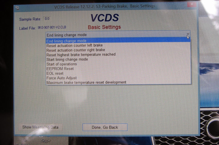

Voici ci-après un extrait du tutos suivant : http://audirevolution.net/forum/index.php?topic=2379.0
Rear brakes
First thing's first. VAGCOM. In 12.12, they've updated the look of how to do this. The old way of doing this was like this.
Basically, turn on your car (no need to start), insert VAGCOM cable, and connect to your laptop. Start VCDS. Now, on VAGCOM, we'll selected '53 - Parking Brake' -> 'Basic Settings - 04' --> to the below screenshot:
Select 'Start lining change mode' and click 'Go'. After you hear the whirring of the parking brake stop, exit/shutdown, and turn off the car. You may now start taking the rear wheel off.
