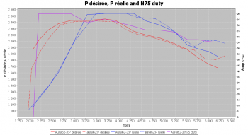

Voila le log des canaux 115 et 114 :
8L0 906 018 N,,1.8L R4/5VT G 0001,
,Group A:,'115,,,,Group B:,'114,,,,Group C:, Non actif
,,Engine Speed,Engine Load,Boost Pressure,Boost Pressure,,Engine Load,Engine Load,Engine Load,Boost Pressure,,,,,
,Repère,(G28),,(specified),(actual),Repère,(specified),(spec. corrected),(actual Value),Control (N75),Repère,,,,
Marker,temps, /min, %, mbar, mbar,temps, %, %, %, %,temps,,,,
,0.29,2080,78.9,1980.0,1060.0,0.01,140.6,137.3,41.4,0.0,,,,,
,0.90,2200,91.7,2110.0,1210.0,0.59,150.4,147.8,86.5,90.2,,,,,
,1.49,2400,107.5,2270.0,1370.0,1.19,165.4,162.7,99.2,90.2,,,,,
,2.10,2640,131.6,2380.0,1610.0,1.79,182.0,179.1,118.8,90.2,,,,,
,2.70,2920,169.2,2430.0,1990.0,2.40,185.7,182.1,148.9,90.2,,,,,
,3.30,3280,191.7,2430.0,2520.0,3.00,189.5,186.6,191.7,82.4,,,,,
,3.90,3680,191.7,2450.0,2540.0,3.60,191.7,189.6,191.7,85.5,,,,,
,4.50,3920,191.7,2430.0,2540.0,4.19,191.7,192.5,191.7,83.1,,,,,
,5.10,4320,191.7,2260.0,2540.0,4.79,191.7,188.1,191.7,79.2,,,,,
,5.70,4600,191.7,2200.0,2420.0,5.39,191.0,179.1,191.7,75.7,,,,,
,6.30,4920,189.5,2150.0,2350.0,6.01,188.7,174.6,179.7,75.7,,,,,
,6.90,5240,176.7,2060.0,2250.0,6.60,186.5,171.6,183.5,74.1,,,,,
,7.50,5520,157.9,1970.0,2040.0,7.20,184.2,164.2,166.2,67.5,,,,,
,8.10,5760,160.9,1840.0,1980.0,7.80,182.0,156.7,156.4,67.5,,,,,
,8.70,6000,157.9,1740.0,1940.0,8.40,179.7,146.3,158.6,65.9,,,,,
,9.30,6200,149.6,1680.0,1860.0,9.00,177.4,141.8,152.6,65.5,,,,,
,9.90,6400,142.1,1670.0,1770.0,9.60,176.7,134.3,149.6,56.5,,,,,

Pour ton log, rien d'anormal pour moi, carto typée couple et peu puissance :
Peu de pression dans les tours mais la consigne est faible aussi. Si elle a toujours été comme ça rien d'anormal donc, par contre si elle marchait mieux avant :reflexion:
Tu sais qui l'a faite cette carto ?
